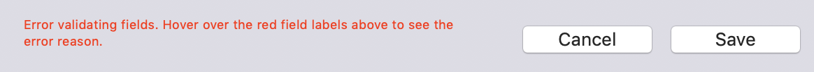

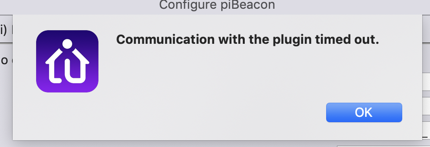

but I get som other strange things I tried to save after disable the "find new beacons"
but then it says like pictures.
Skærmbillede 2019-02-24 kl. 14.07.39.png (37.72 KiB) Viewed 3492 times
Skærmbillede 2019-02-24 kl. 14.07.25.png (253.23 KiB) Viewed 3492 times
and there is no "red" fields.
Re: lots of errors
Anything in the logfile?
Could email me print
Config
Beacons
Etc
It in the menu /print ....
It has password etc. you might want to xxx them.

I see these that probably explain it
2019-02-27 06:39:24.658 ERROR Plugin.updateBeaconStates in Line '12557' has error='ServerCommunicationError -- timeout waiting for response'
2019-02-27 06:39:26.698 ERROR Plugin.updateBeaconStates communication to indigo is interrupted
2019-02-27 07:01:58.752 ERROR Plugin.fixConfig in Line '2179' has error='ServerCommunicationError -- timeout waiting for response'
2019-02-27 07:02:00.909 ERROR Plugin.fixConfig communication to indigo is interrupted
executeUpdateStatesDict: key: closestiBeacon not in states for dev:Car beacon
27 07:05:17 significant internal delay occured digesting data from rPi: 1 4.9042555.1 [secs]
2019-02-27 07:50:09.947 ERROR Plugin.BLEconnectCheckPeriod in Line '9162' has error='ServerCommunicationError -- timeout waiting for response'
27 07:50:45 significant internal delay occured digesting data from rPi: 0 15.9346855.1 [secs]
27 07:50:45 significant internal delay occured digesting data from rPi: 1 15.9094445.1 [secs]
2019-02-27 07:52:13.921 ERROR Plugin.BLEconnectCheckPeriod in Line '9162' has error='ServerCommunicationError -- timeout waiting for response'
07:53:11 deleting beacon: Car beacon replacing simple beacon with rPi model(1)
deleting beacon: piBeacon-Pantry replacing simple beacon with rPi model(2)
creating new pi 3-- 0 0 B8:27:EB:32:D2:3B
27 07:53:11 -setting beacon device in internal tables to 0: Car beacon 61452173 enabled:True pluginState:run
27 07:53:17 significant internal delay occured digesting data from rPi: 1 6.6333955.1 [secs]
27 07:53:18 significant internal delay occured digesting data from rPi: 0 6.0374505.1 [secs]
27 07:53:18 significant internal delay occured digesting data from rPi: 1 5.6138995.1 [secs]
27 07:53:18 significant internal delay occured digesting data from rPi: 1 5.6353205.1 [secs]
27 07:55:02 significant internal delay occured digesting data from rPi: 0 10.9508115.1 [secs]
please do "sudo raspi-config" on rPi: 0, set time, reboot ... send: TIME-Tsend= 2220 /epoch seconds UTC/ timestamp send=1551251882.7; TZ send is=BST
please do "sudo raspi-config" on rPi: 0, set time, reboot ... send: TIME-Tsend= 2212 /epoch seconds UTC/ timestamp send=1551251890.89; TZ send is=BST
2019-02-27 08:54:08.234 ERROR Plugin.updateBeaconStates in Line '12557' has error='ServerCommunicationError -- timeout waiting for response'
2019-02-27 08:54:25.815 ERROR Plugin.updateBeaconStates communication to indigo is interrupted
27 08:56:44 significant internal delay occured digesting data from rPi: 0 13.3925535.1 [secs]
2019-02-27 09:55:58.621 ERROR Plugin.updateAlive in Line '10305' has error='ServerCommunicationError -- timeout waiting for response'
2019-02-27 09:56:55.057 ERROR Plugin.updateAlive communication to indigo is interrupted
2019-02-27 09:56:38.633 ERROR Plugin.updateBeaconStates in Line '12557' has error='ServerCommunicationError -- timeout waiting for response'
2019-02-27 09:56:55.058 ERROR Plugin.updateBeaconStates communication to indigo is interrupted
27 09:56:55 significant internal delay occured digesting data from rPi: 1 16.4271635.1 [secs]
2019-02-27 10:00:48.233 ERROR Plugin.updateBeaconStates in Line '12557' has error='ServerCommunicationError -- timeout waiting for response'
2019-02-27 10:00:51.041 ERROR Plugin.updateBeaconStates communication to indigo is interrupted
fixing: Pi_00:19:86:00:08:93 beaconDEV:00:19:86:00:08:93 beacon:B8:27:EB:32:D2:3B beacon wrong, using current beacon-mac
setting beacon: B8:27:EB:32:D2:3B to ignore was set to indigo-id=0 before
{u'minSignalCutoff': u'-999', u'receivedSignals': [{'rssi': -999, 'lastSignal': 0, 'distance': 99999}, {'rssi': -89.9, 'lastSignal': 1551261651.429288, 'distance': 99999.0}, {'rssi': -999, 'lastSignal': 0, 'distance': 99999}, {'rssi': -999, 'lastSignal': 0, 'distance': 99999}, {'rssi': -999, 'lastSignal': 0, 'distance': 99999}, {'rssi': -999, 'lastSignal': 0, 'distance': 99999}, {'rssi': -999, 'lastSignal': 0, 'distance': 99999}, {'rssi': -999, 'lastSignal': 0, 'distance': 99999}, {'rssi': -999, 'lastSignal': 0, 'distance': 99999}, {'rssi': -999, 'lastSignal': 0, 'distance': 99999}], u'showBeaconSymboluseErrorSize': u'1', 'showBeaconNickName': u'', u'PosZ': 0.0, u'PosX': 0.0, u'PosY': 0.0, u'signalDelta': u'999', u'updateFING': 0, u'showBeaconSymbolColor': u'b', u'beaconTxPower': 999, u'note': u'Pi-1', u'expirationTime': 90.0, u'batteryLevel': '', u'status': u'ignored', u'updateSignalValuesSeconds': 300.0, u'indigoId': 0, u'fastDownMinSignal': -999, u'fastDown': u'0', u'created': u'2019-02-26 13:26:33', u'lastUp': 1551261651.429063, u'updateWindow': 1551261427.946211, u'showBeaconOnMap': u'0', u'ignore': 0, u'showBeaconSymbolAlpha': u'0.5', u'typeOfBeacon': u'rPI'}
2019-02-27 10:36:20.008 ERROR Plugin.fixConfig in Line '2249' has error='ServerCommunicationError -- timeout waiting for response'
