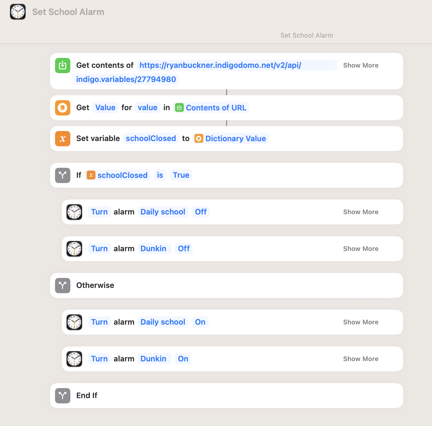

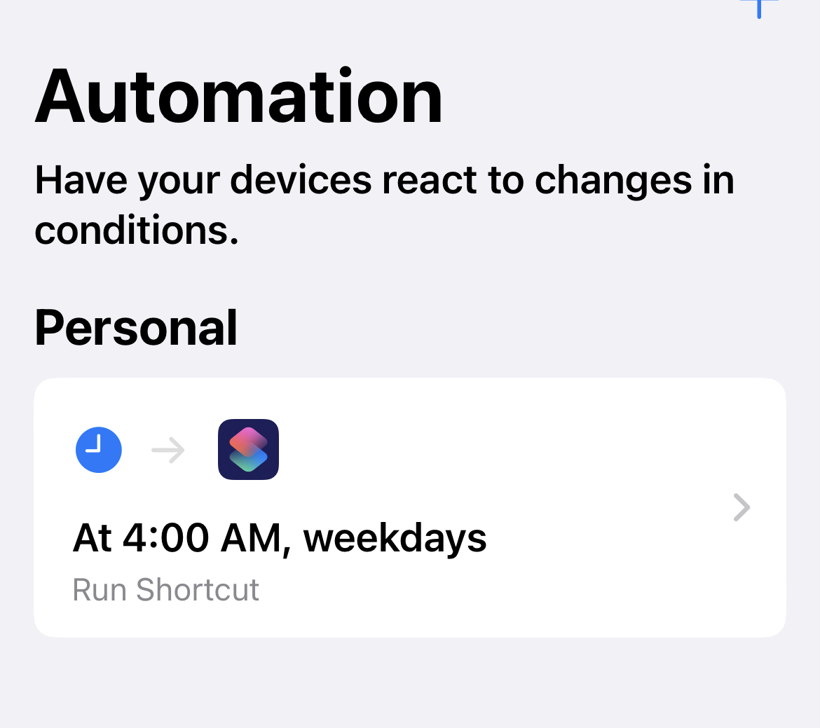

So I created a shortcut that looks like this: And then I have an automation that runs from my phone every morning at 4:00AM to run the shortcut

ryanbuckner
Posts: 1400
Location: Northern Virginia
Re: Set alarm clock in iOS and in Indigo
Post by ryanbuckner »
jay (support) wrote:Nice! Per Dave's post above, please let us know if it runs unattended tomorrow morning.
I moved the time up and ran a few tests with the Indigo variable = False and then = True . I locked the phone and both times the shortcut ran unattended and produced the desired outcome.
The "Notify When Run" option is really handy to see when steps fire. All looks good.
