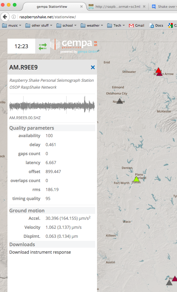

got my shake ( kickstarter earth quake detector) up and running .. just the first steps.. and the network is growing..
Will try to add some plugin to indigo to get movement warnings or some graphs.
The setup is very sensitive. it must not be next to AC, vents, speaker, washing machines, fridge, motors (garage door)
Best would on a concrete slab with constant 60ºF temp, no wind no rain .. walking by it will register
ps: mine is the one in the middle of dallas

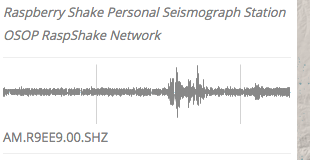

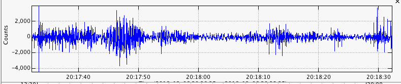

Re: raspberry shake
coming home (slamming the door) and walking up the stairs... this has real potential
ordered a second to put 2 into my house, front and back
Screen Shot 2016-12-06 at 14.21.43.png (19.68 KiB) Viewed 4824 times
Re: raspberry shake
coming home: the detailed data using swarm ..
Screen Shot 2016-12-06 at 15.21.29.png (15.37 KiB) Viewed 4776 times
as compare to being away:
Screen Shot 2016-12-06 at 15.22.43.png (13.72 KiB) Viewed 4776 times
this is a real good presence sensor

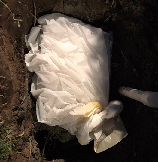

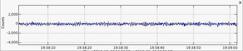

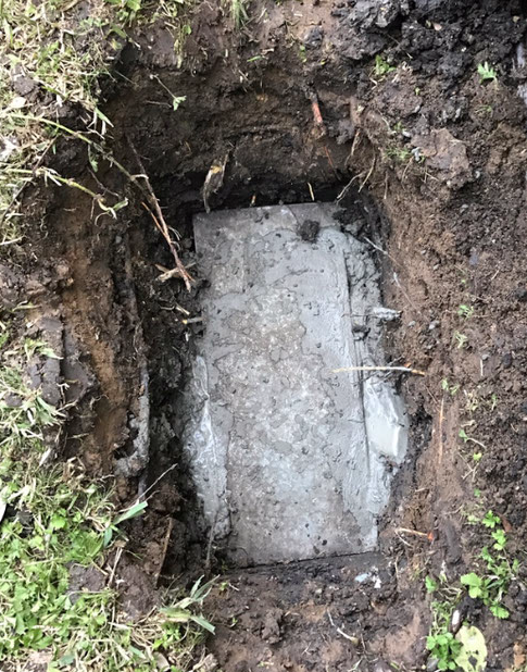

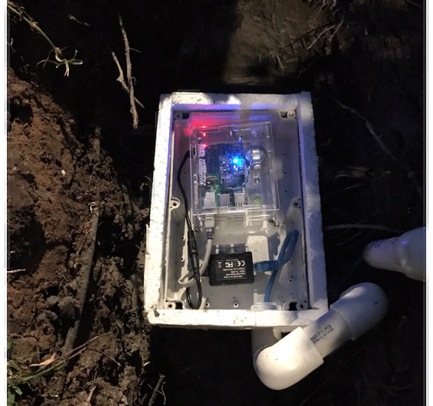

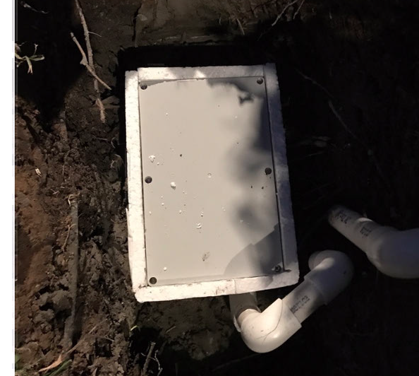

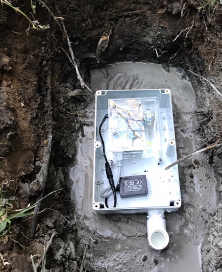

Re: raspberry shake
have now 2 raspberry shakes.
=== one inside = detect movements, door open/ close
=== one outside in a 2 feet deep hole sitting on a concrete slab covered with styrofoam on top and side, then wrapped into a plastic bag and finally covered with earth .
The PEO cable goes up through a U back down into the open earth then into the pipe back into the house.
The end of the pipes are filled with silicone so that water does not come in.
The 2 pipes do not connect so that movements of the outside pipe (e.g. rain, wind) do not enter the box with the pi.
Here some pictures of the setup:

The raspberry shake underground is ~ factor 10 better in terms of background..
Waiting for some earthquakes .. when they do heavy fracking again we will get some at strength ~ 2-4
will try to integrate them into indigo .. have my next project
