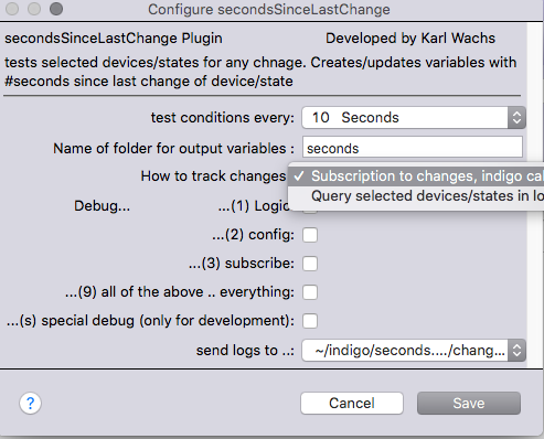

1. In CONFIG: Name of folder where the variables should go.
Screen Shot 2018-10-30 at 13.36.19.png (72.33 KiB) Viewed 8156 times
2. IN CONFIG: use subscription to changes(indigo calls this plugin for any change in any device) or test values of the selected device/state in a loop every xx seconds.
both work. you can try both modes. the load on the system depends on the number of changes, number of devices and # of device/states you like to track.
3. IN CONFIG: frequency of checks . This is essentially the "self.sleep( time)" between actions : 0.5 seconds .. 10 seconds.
In LOOP mode nothing happens in-between. In Subscribe mode, the variable gets set to "0" if there was a change for the device/state.

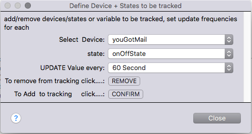

4. In MENU: the update frequency -if no change - for EACH device/state or variable, i.e. how often the # of seconds should be updated: 1 second .. 3 minutes
Screen Shot 2018-10-30 at 13.38.15.png (39.31 KiB) Viewed 8156 times

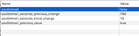

This is how the variables look like, the numbers are the seconds since last change:
Screen Shot 2018-10-30 at 12.49.01.png (16.08 KiB) Viewed 8156 times
