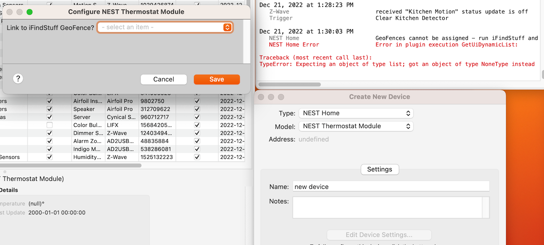

Unfortunately even if you haven't moved to google home accounts the Nest API auth page just give an "oops we encountered an error. Please try again" when you attempt to get your pin. So I looked around the interwebs and found instructions to get your auth token from your nest account: https://github.com/chrisjshull/homebridge-nest
So I gave that a try. I got the token added it to the plugin and restarted the plugin for good measure. In the indigo event log it now says "data tracking online". I think this is good news. The only problem now is that I can't add a thermostat. I get this error when the device chooser appears with no choices:
NEST Home Error                 Error in plugin execution ServerReplacedElem:
  File "plugin.py", line 2134, in deviceUpdated
  File "plugin.py", line 2156, in dataChange
KeyError: key nestAway not found in dict
   NEST Home                       GeoFences cannot be assigned - run iFindStuff and try again
   NEST Home Error                 Error in plugin execution GetUiDynamicList:
TypeError: Expecting an object of type list; got an object of type NoneType instead
Just seems like a data type error, if someone could maybe give a quick fix we'd be back in business! :D :D :D
