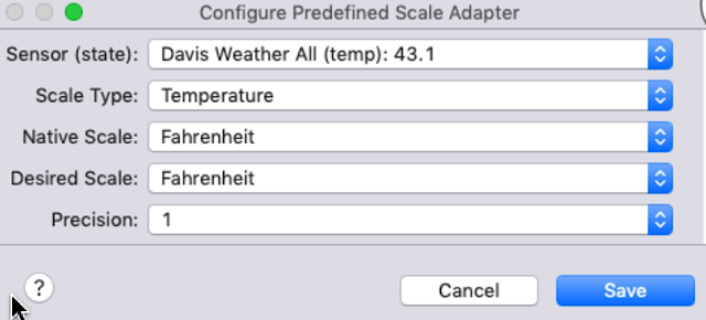

ckeyes888
Posts: 2438
Location: Kalispell, MT
Re: Adapters Plugin - Issue Removing Decimal
Post by ckeyes888 »
Tried the settings you mentioned but am still getting the decimal.
Missed something? Still returns 43.1
Carl
ckeyes888 wrote:Tried the settings you mentioned but am still getting the decimal.
Missed something? Still returns 43.1l
Set "Precision" to 0.
