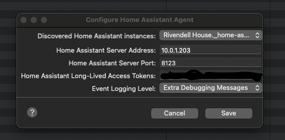

So getting back on this now.
On my Indigo machine if I go to the HA webpage (in safari) I can connect to that fine and control it.
In indigo Plugins>Home Assistant Agent>Configure... It discovers the server and if I delete all the server info, save the config, restart indigo, go back to the config it still discovers it and fills out all the information. I put the long lived key in and it still won't connect.
is there a plugin config file I can delete somewhere?
Screenshot 2023-08-13 at 13.58.57.png (54.08 KiB) Viewed 2453 times
Re: Home Assistant plugin updated for Python 3
Just to be sure, do the IP address and port in the config dialog match what you use in Safari to connect to Home Assistant?
You can remove the plugin preferences file. It's in the Indigo install directory, then Preferences, then Plugins, then "no.homeassistant.plugin.indiPref". Don't delete that file right away, just move it out of the plugin preferences file. First disable the plugin, then move the prefs file, then enable the plugin. Remember to reenable debug logging. If that does happen to fix the problem, let me know. I'll want to look at the old preferences file to see if I can figure out why it broke things.
If it's still not working, post the (new) log.

Hi yes the IP and Port Match
Tried moving the prefs file and no luck same thing again. Something I did notice is I just restarted the HA instance and this instantly popped up in the indigo log.
 Home Assistant Agent Debug      Service Rivendell House._home-assistant._tcp.local. of type _home-assistant._tcp.local. state changed: ServiceStateChange.Removed
Does this suggest it can partly see the server and what's happening.

Pretty much the same thing in the log.
Could there be any setting in HA that could be stopping it?

Also if I copy and paste this: 10.0.1.203:8123/api/websocket from the LOG in to safari on the Indigo machine i get this:
No WebSocket UPGRADE hdr: None
Can "Upgrade" only to "WebSocket".
You won't be able to connect to the websocket URL with a browser. So that error is expected.
You said this was working a few days ago? Was that with the old plugin or the new Python3 version?
What is Home Assistant running on? What hardware, OS, etc?
Also, until you get this fixed, you should disable all the HAA devices in Indigo. That will keep the log from getting spammed. Uncheck the "Comm Enabled" checkbox in the Indigo UI for all these devices.
Also, please enter this in a Terminal window and post the results:
pip3 show websocket-client
And...
I just pushed an update to GitHub that sets a specific timeout on that websocket connection. Maybe the error message will tell us something.
https://github.com/FlyingDiver/Indigo-H ... master.zip
You'll have to manually unpack and drop that in the plugins folder (and then restart the plugin). I didn't bump the version number, so Indigo won't do the install for you.
