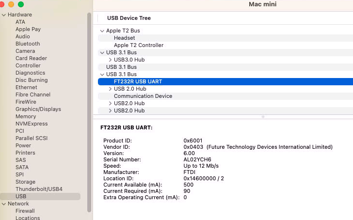

Ok, sorry, so it doesn't look like I actually installed the driver from the adapter maker. The system seems to show it's using the built in one.

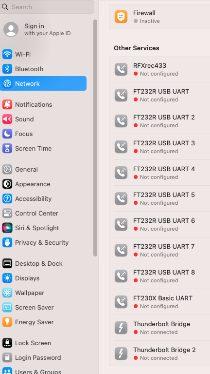

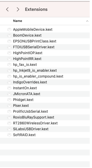

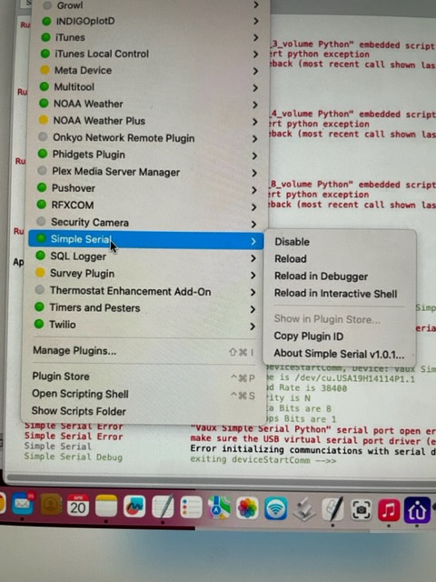

Well, I bought the GearMo adapter, and it shows up in the bottom picture. You can see the pull down menu for the Z-wave converter, so it is recognized by the Mac. The port settings did have. bunch of keyspan devices, which I deleted. I went to /Library/Extensions and deleted the Keyspan .kext. I have unplugged all the USB cables and restarted the Mac. Still no luck as you can see from this persistent error.
Why would this old Keyspan unit be locked in to the plugin? I looked through the plugin with BB edit and I'm not sure why it is not seeing the usb-serial converter, especially since the Z-Wave menu sees it with no problem. Any thoughts how to release it?

Starting plugin "Simple Serial 1.0.1" (pid 5813)
Started plugin "Simple Serial 1.0.1"
Simple Serial Debug <<-- entering deviceStartComm, Device: Vaux Simple Serial Python; ID=775789076, Type=simpleSerialCommunicator
Simple Serial Debug Serial Port Name is /dev/cu.USA19H14114P1.1
Simple Serial Debug Serial Port Baud Rate is 38400
Simple Serial Debug Serial Port Parity is N
Simple Serial Debug Serial Port Data Bits are 8
Simple Serial Debug Serial Port Stops Bits are 1
Simple Serial Error "Vaux Simple Serial Python" serial port open error: [Errno 2] could not open port /dev/cu.USA19H14114P1.1: [Errno 2] No such file or directory: '/dev/cu.USA19H14114P1.1'
Simple Serial Error make sure the USB virtual serial port driver (ex: FTDI driver) is installed and correct port is selected
Simple Serial Error initializing communciations with serial device Vaux Simple Serial Python
Simple Serial Debug exiting deviceStartComm -->>

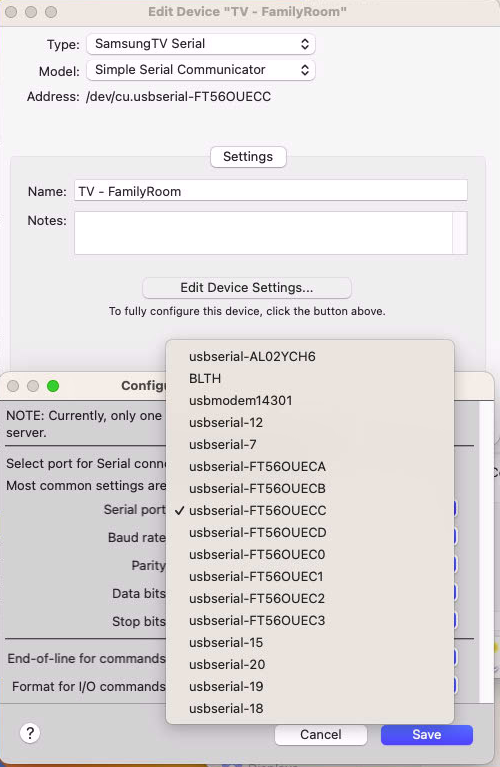

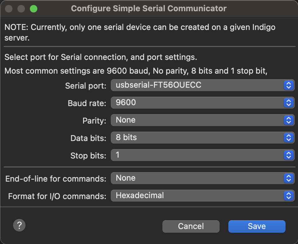

Your "Simple Serial" plugin is still pointing to USA19H, you need to reconfigure it to use usbserial-FTxxxxx, should be one of those /dev/cu. usbserialFT7ERMNx, you can try one by one to figure out which one is being used.
To configure to different serial port you need to go to your existing device (mine is Samsung TV in the picture) and click on Edit Device Settings... you will see Serial port drop down menu..

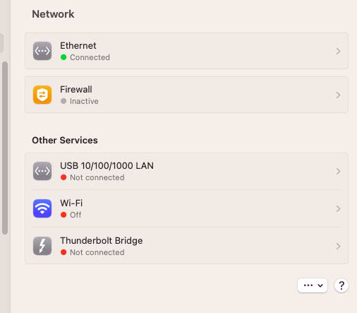

Also, your Network shows bunch of the FT232R services configured, mine doesn't have any, you might want to delete them to free them up if you are not using them for other purposes.

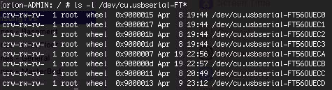

xxxxx-Mac-mini-5:Receipts xxxxxx $ ls -l /dev/cu.usbserial-FT*
crw-rw-rw- 1 root wheel 0x900000b Apr 20 06:23 /dev/cu.usbserial-FT7ER4MN0
crw-rw-rw- 1 root wheel 0x9000003 Apr 20 06:23 /dev/cu.usbserial-FT7ER4MN1

Not sure where that would be in the code, The plugin serial settings were intended be configured via GUI. That's what I did and the indigo device screenshot in my previous post. That's the the way how I did it and that's how you would change the serial device.
What happens when you try to set it using Indigo?

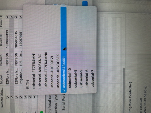

When I set it, I do not see the GUI. This is what comes up.

Re: Newer version of Indigo 2022.x.x
You can't set it in the plugin but rather the indigo device that you create and assign "Simple Serial" to it as the type/model.
In your Indigo create a new device
for the Device Type drop down choose "Simple Serial"
for Model choose "Simple Serial Communication"
Click "Edit Device Settings..." and you will see serial port selection (like on the screenshot)
You know what, that’s probably my issue. I completely forgot that I had to set the device.
Thanks for your patience… Really appreciate it. I’ll let you know.
