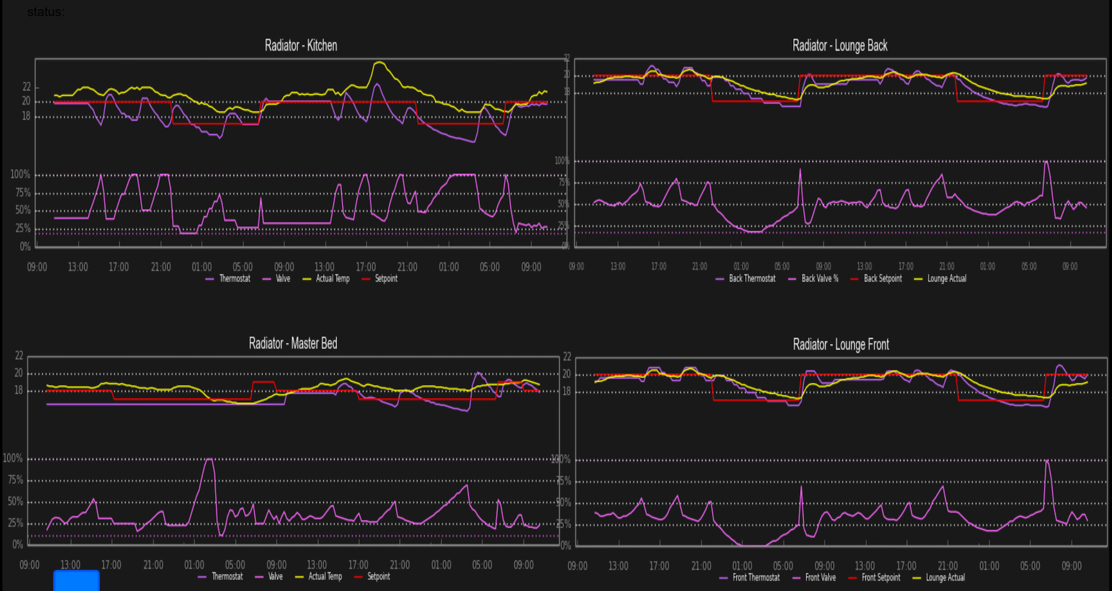

2. Radiator Behaviour.
I have been tracking the Spirit TRV - not under TRV Controller
Graph of TRVs
Graph of TRVs
The Valve closes as it gets near the SetPoint, meaning it can take an hour or two to hit the set point to move 1 degree.
This results in non controlled TRVs (i.e. hallway near house thermostat) in massively over running and over heating spaces i.e. running the heating system for an hour or more longer than is required.
Again - not fully into TRV Controller, yet - will it address this issue?
Less of an issue if you have a controlled TRV on every radiator - ( I currently have 8 controlled TRVs, and 20 Radiators all together)
My theory was that the toilets/bathrooms/ensuites can overheat if not on controlled TRVs, but I don't mind as I have never had anyone complain about a warm bathroom and they are usually quite small.

The schedules work on a daily basis; that is start at midnight and end at midnight. So if you want to set a schedule from 22:00 -> 06:00 you would have to set one for 22:00 - 23:59 and from 00:00 - 06:00. I worked it this way to make my life simple by avoiding having to work out how to handle multiple days. :)
The reason you need to leave a 10 minute gap between a schedule end and start is probably a bit of a legacy thing but it stops overloading the TRVs with a lot of messages around the schedule change. I don't think it should cause a problem with your setup.
The plugin is working as designed (which may not be ideally what you want). :)
When I have a bit more time I might introduce a different scheduling algorithm which is rather than having ONs and OFFs, have scheduled setpoint values which I think would suit your use case better.
Probably not what you want to hear, but if you have a TRV Controlled system you really need to have all the radiators controlled otherwise you are going to be wasting heat on uncontrolled radiators. This control could be via ordinary manual TRVs but this requires manual intervention.
If you are using Remote thermostats to control the rooms than you can set a Delta T value (e.g. +5 deg C) which means that if you set the Remote setpoint to say 21 deg C, the TRV Controller sets the TRV (Spirit) to 26 deg C. This will keep the valve open until it gets switched off when the Remote gets to 21 deg C. The main use of this is to make sure that the Spirit doesn't turn off early because of nearby heat from the radiator even though the room isn't up to temperature.
Hope that helps explain the rationale. :)
