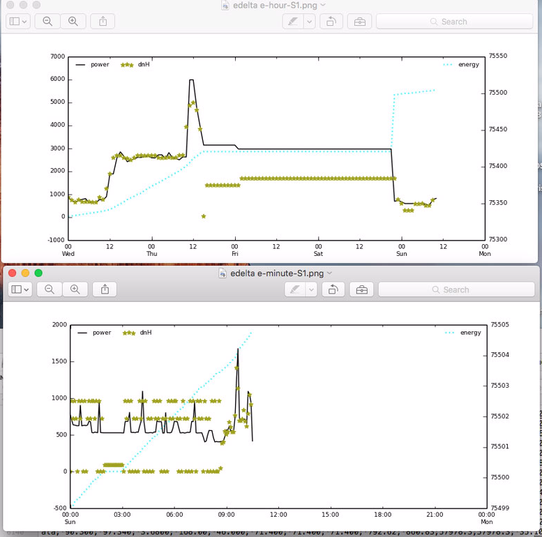

Marc on the "delta norm hour for min vs hour plot
Screen Shot 2017-03-12 at 10.35.22.png (292.03 KiB) Viewed 12520 times
attached graph
1. upper part is the hour plot, the lower part is the minute plot
2. 3 lines:
blue = energy (aeon calls it accumulated energy thats actually wrong .. that would be power *hour*hour, energy is power *hour or in units=W*hour.. anyway), right scale [KWh]
black line = power (watt)
yellow dots = delta energy normalized to 1 hour [KWh/h * multiplier1000 to make it watt)
you can see several things:
1. my z-wave network was not doing well for some days = no updates
2. delta norm hour is not very accurate as the enegery from the aeon device is not updated often enough
(Energy(n) - Energyr(n-1) )/ deltaTime * normalization factor has some holes. many of the yellow dots are at zero
you can run indigo utilities and look at the sql data for the device. You could see that power is updated more frequently than energy - al least in my case(*)
I do not see any difference with data from SQL and from regular data acquisition.
sql import and regular acquisition are indeed are 2 different programming parts. There could be an issue, but I do not see it .

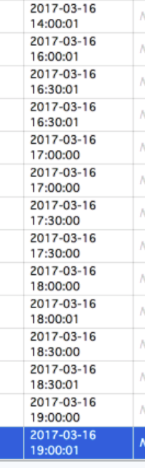

if you look at the date column
Screen Shot 2017-03-16 at 15.14.50.png (66.86 KiB) Viewed 12458 times
the values are only updated every 30 minutes.
then doing a delta every 5 minutes will get you most of the time 0. only around :00 and :30 you should get a small value. .. the usage is ~ 200 Watt that gives 0.2 KWH .
dividing that by 60 to get to minutes that gives an even a smaller number.
that would explain it:
in SQL import if you don't have a current value it takes the last one. in the regular mode it tries to do a delta, but there was nothing in the last bin. I could change that to check the last bin with value..
and by the way why do you want to make it complicated: the device delivers the Watts as currentenergylevel. just use that one..delta norm hour is supposed to emulate that value if your device does not deliver it. It is for simple counters that only deliver an ever increasing number.

ok I thought about it. the issue is there is missing data. if you don't have data in a bin, how to decide what to use..
the sql import scans through the raw data and interpolates if no data bin is available. it does not calculate the current value as there are not 2 values available.
the regular mode (every 5 minutes) looks at the current value and the value from the last bin and calculates the delta. if there is no data in the last bin one could use the last value and time then calculate an estimate with the current value, but if current value == old value the result must be zero if no data was read. that might lead to a gross over or underestimation in individual bins
Currently the normal mode does not recalculate past values / bins.
If we want to change that i need to restructure the program.. (keep last valid data point & timestamp then recalculate all bins from the last valid point forward ..
There is an issue one way or the other if you have missing data and want to do interpolation.
This is actually interesting, but it will take me some time.. I hope this makes sense ..
