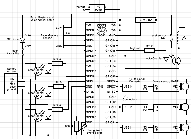

added features / changes in added features / changes in v2022.185.139 @ 2025-04-24
1. fully support face and gesture sensor together with DF2301Q
- Have a box with 3 DF2301Q connected through USB to serial converters and one face gesture sensor on i2c
-- it drives a somfy RF remote (up/down/stop) through gpio and opto couplers hat simulate button presses.
- Both sensor have an option to drive directly gpios on the rpi or issue unix commands, set in device edit.
- As the i2c connection is not stable (hangs about 1/day) you have the option to reset the sensor through a relay that toggles the power, see drawing.
-- that is done automatically when detected, automatically fixed within < 10 secs
2. various little improvements
-exception handling
-fixed python compiler warnings (different return types etc)
circuit for my gesture + 3 voice sensor setup:
Screenshot 2025-07-08 at 12.28.33.png (97.29 KiB) Viewed 735 times

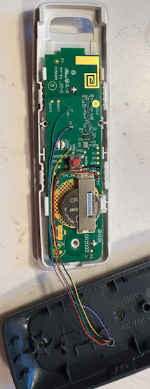

connection to SomFy remote:
Screenshot 2025-07-09 at 22.19.35.png (266.79 KiB) Viewed 735 times

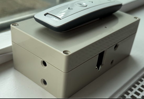

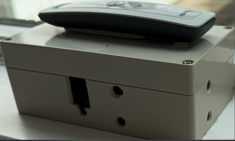

the box:
Screenshot 2025-07-09 at 22.23.17.png (306.54 KiB) Viewed 735 times
Screenshot 2025-07-09 at 22.25.22.png (437.24 KiB) Viewed 735 times
you can see 2 holes on 2 sides for the mics and the bigger hole for the face gesture sensor
