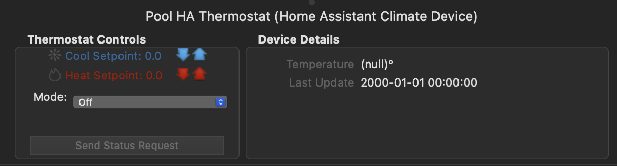

Re: Home Assistant plugin updated for Python 3
Created new climate devices
I selected it from the list
No info, no action
When trying to change the temp:
No info, no action
Aug 3, 2023 at 5:11:40 PM
Home Assistant Agent Debug Pool HA Thermostat: _handleChangeSetpointAction: setpointHeat 1.0
Home Assistant Agent Debug Pool HA Thermostat: _handleChangeSetpointAction: setpointHeat -1.0
Home Assistant Agent Debug Pool HA Thermostat: newHVACmode: 1 (heat)
Home Assistant Agent Debug Updating device Pool HA Thermostat with {'entity_id': 'climate.pool', 'state': 'heat', 'attributes': {'hvac_modes': ['heat', 'off'], 'min_temp': 32, 'max_temp': 104, 'current_temperature': 89, 'temperature': 55, 'friendly_name': 'Pool', 'supported_features': 1}, 'last_changed': '2023-08-03T21:11:46.348709+00:00', 'last_updated': '2023-08-03T21:11:46.348709+00:00', 'context': {'id': '01H6YKW0XJKFTW09GXENDWJEW0', 'parent_id': None, 'user_id': '250b207b7a25402ebf30cecb8cef41a0'}}
Home Assistant Agent Error Websocket state_changed exception: 'fan_mode'
Home Assistant Agent Debug Websocket state_changed:
{'id': 1, 'type': 'event', 'event': {'event_type': 'state_changed', 'data': {'entity_id': 'climate.pool', 'old_state': {'entity_id': 'climate.pool', 'state': 'off', 'attributes': {'hvac_modes': ['heat', 'off'], 'min_temp': 32, 'max_temp': 104, 'current_temperature': 89, 'temperature': 55, 'friendly_name': 'Pool', 'supported_features': 1}, 'last_changed': '2023-08-03T20:48:08.401756+00:00', 'last_updated': '2023-08-03T20:49:51.737334+00:00', 'context': {'id': '01H6YJKY3SNSQ52PBDZ35CTWTB', 'parent_id': None, 'user_id': None}}, 'new_state': {'entity_id': 'climate.pool', 'state': 'heat', 'attributes': {'hvac_modes': ['heat', 'off'], 'min_temp': 32, 'max_temp': 104, 'current_temperature': 89, 'temperature': 55, 'friendly_name': 'Pool', 'supported_features': 1}, 'last_changed': '2023-08-03T21:11:46.348709+00:00', 'last_updated': '2023-08-03T21:11:46.348709+00:00', 'context': {'id': '01H6YKW0XJKFTW09GXENDWJEW0', 'parent_id': None, 'user_id': '250b207b7a25402ebf30cecb8cef41a0'}}}, 'origin': 'LOCAL', 'time_fired': '2023-08-03T21:11:46.348709+00:00', 'context': {'id': '01H6YKW0XJKFTW09GXENDWJEW0', 'parent_id': None, 'user_id': '250b207b7a25402ebf30cecb8cef41a0'}}}
Home Assistant Agent Debug Updating device Pool HA 04-Heater (HA Plugin) with {'entity_id': 'switch.pool_heater', 'state': 'on', 'attributes': {'icon': 'mdi:radiator', 'friendly_name': 'Pool Heater'}, 'last_changed': '2023-08-03T21:11:46.349452+00:00', 'last_updated': '2023-08-03T21:11:46.349452+00:00', 'context': {'id': '01H6YKW1XDNJZ607Z3TA4E3MDX', 'parent_id': None, 'user_id': None}}
Home Assistant Agent Debug Websocket unknown message type: {"id": 1, "type": "event", "event": {"event_type": "automation_triggered", "data": {"name": "MQTT-Pool-Temp-Setpoint", "entity_id": "automation.mqtt_pool_temp_setpoint", "source": "mqtt topic homeassistant/climate/pool/temperature"}, "origin": "LOCAL", "time_fired": "2023-08-03T21:11:46.371004+00:00", "context": {"id": "01H6YKW1Y2EZT9Z6B3N8YDZ20V", "parent_id": null, "user_id": null}}}- Attachments
- Screenshot 2023-08-03 at 5.08.57 PM.png (52.64 KiB) Viewed 2340 times

Wait. This is a pool heater with no fan? That might be the problem. Let me look into that.roquej wrote:Created new climate devices
No info, no action
What's the source for the data? Looks like it might be going through the HA MQTT integration.

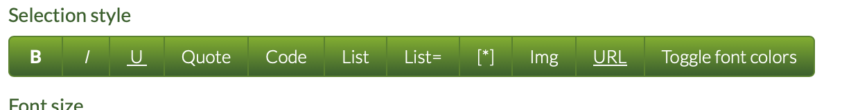

- Posts: 7830
Seriously, it's not a hard button to use. It's this one:
Posting the errors from when you created the device first would have been better. Just saying.

- Posts: 7830
Not sarcastic, really. You're just causing me more work. When you post code or log segments, use the button above the text input box labeled "Code" to put code tags around those text lines, which makes them much easier to read.
- Screenshot 2023-08-03 at 5.42.21 PM.png (33.03 KiB) Viewed 2342 times
