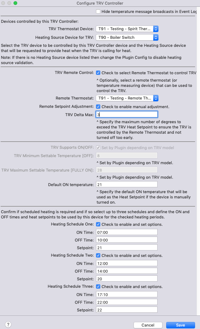

Having used these for a while, I'm confused at to how the plugin works with the remote temperature sensor?
If the set point is 20, the spirit is measuring 21 but the remote sensor says 18, how does it tell the spirit to come on? Does it force it into boost, therefore 100% open, or adjust the set point on the spirit?
Watching the way the spirit controls the valve, as the temp approaches the set point the valve slowly closes, reducing the hot water so slowing the temp increase so it doesn't over shoot. (in theory)
Also it keeps it slightly open whilst temp is above set point to ensure the room temp doesn't drop quickly. Not sure if the Stella was same or just on or off only?
autolog
Posts: 4077
Location: West Sussex, UK
Post by autolog »
It adjusts the set point on the Spirit by a user defined amount (TRV Delta Max) - as in configuration shown below:

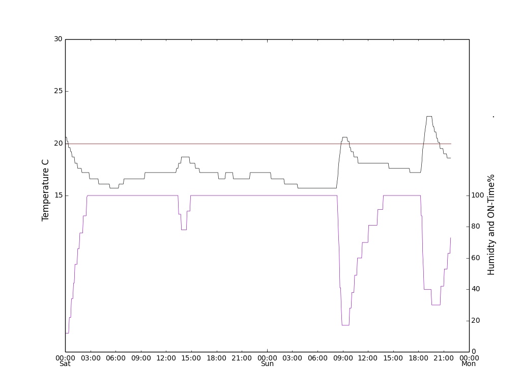

siclark
Posts: 2355
Location: UK
Post by siclark »
You said you have one on your desk testing, but have you got one on a radiator?
It would be cool if you could get to the point of controlling the valve directly and stop the m temperature shooting they the set point. I think the valve should start closing before the set point is reached.
Ignore the axis titles. This is temp and set point on top, and valve % open below. It seems to nicely ramp the valve when increasing openness. However as temp increases it is full open until temp shoots through the set point. It doesn't lead to a smooth temperature profile!
If the thermometer is away from the heater you will always have a delay in temp measurement. And the heater also has some capacity it will continue to heat even when it is off.

siclark
Posts: 2355
Location: UK
Post by siclark »
kw123 wrote:If the thermometer is away from the heater you will always have a delay in temp measurement. And the heater also has some capacity it will continue to heat even when it is off.
This thermometer is on the radiator as part of the trv. Agree the over heat can occur as the radiator still has hot water in it once the valve is turned off, which is why on what is already a smart trv, it doesn't take that into account. It clearly has the ability to part close the valve so could do to try and reduce this effect.

siclark
Posts: 2355
Location: UK
Post by siclark »
This is perfect example. It slowly reopens the valve to start heating (although doesn't do much good as boiler is off) but doesn't slowly close the valve.
