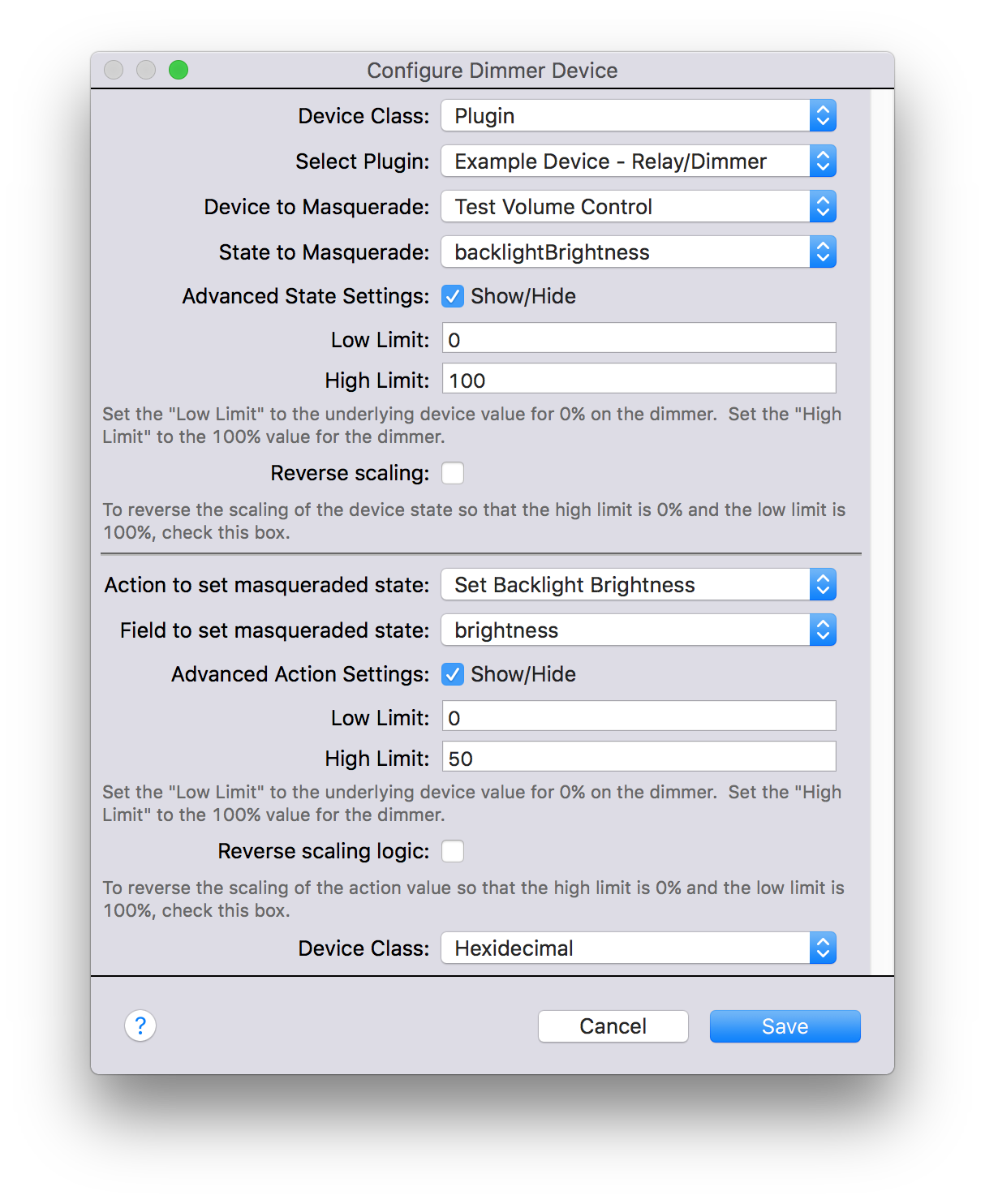

Nevermind. I looked at the Russound plugin code to see what it's doing.
https://github.com/FlyingDiver/Indigo-M ... tag/v0.0.6
You're going to need to set up the Device configuration very carefully for this to work. It's going to look like this:
Screen Shot 2016-12-15 at 12.56.01 PM 12-15.png (358.52 KiB) Viewed 8300 times
The state scaling is 0-100, because that's the range of the Volume state variable.
The action scaling is 0-50, because that's the actual range the device accepts, even though the set volume pop-up is showing 0-100. It's lying.
And the action expects that value to be Hex, so that's the last popup. I forgot to change the label on that one, it'll be fixed in the next release.

Hi Joe
I have set up exactly as you said but the logic doesn't seem to be working
Amend the dimmer to 78 this is the debug
   Masquerade Debug                scaleMasqToBase: lowLimit = 0, highLimit = 50, reverse = False, input = 79, format = Hexidecimal, scaled = 27
   Masquerade Debug                actionControlDevice: "Living Room Music" Set Brightness to 79 (scaled = 27)

So the scaling isn't working but all else seems ok if i now amend the scaling on both to 100
Now set dimmer to 57 and this happens and the dimmer shows 28
   Masquerade Debug                validateDeviceConfigUi, typeID = masqDimmer
   Masquerade Debug                scaleMasqToBase: lowLimit = 0, highLimit = 100, reverse = False, input = 57, format = Hexidecimal, scaled = 39
   Masquerade Debug                actionControlDevice: "Living Room Music" Set Brightness to 57 (scaled = 39)
So it looks like the Hex is working but the dimmer scaling in not, could it be that the top value is also using Hex?

I don't get it. All of those look exactly correct except for the last one where you changed the scaling. You should not be looking at the scaled number in the debug output. That's the internal value passed to the Russound plugin, and it's actually a hex number. You just didn't happen to set it to any values where the output would obviously be hex.
In all three tests, the number you set the slider to on the Masquerade device is the same as the number reported by the Russound plugin after the update:
   Masquerade Debug                dimmerDeviceUpdate: Russound Zone 1 (78) --> Living Room Music (78)
If you attempt to put in an odd number from the slider (or any other method) it's going to get rounded down because the device actually only has a range of 50 (not 100).
So what are you expecting to see different?

What I'm expecting is that 100% on the slider would equal a 50 on the russound state as 50 would be the max volume

Nope. The Russound plugin scales that value to 100. Try setting max value using the Russound Plugin action and see what you get.
Which is why back in http://forums.indigodomo.com/viewtopic. ... 49#p130653 I asked you to post the values of that state after setting various volume settings. You didn't, so I looked at the code to see what it was doing.

Your right the russound plugin will go to 100 but that almost blows your speakers so I was hoping that we could restrict it so that maximum on the slider (100%) would equal 50 on the volume state. This is what i assumed the scale section would do
Posts: 7823
Re: Masquerade Plugin
Ksullivan wrote:Your right the russound plugin will go to 100 but that almost blows your speakers so I was hoping that we could restrict it so that maximum on the slider (100%) would equal 50 on the volume state. This is what i assumed the scale section would do
No, the scaling is to match the dimmer range (0-100) to the underlying device range. Limiting the range is out of scope for the plugin. You'll need to do that in your control pages or some such.
