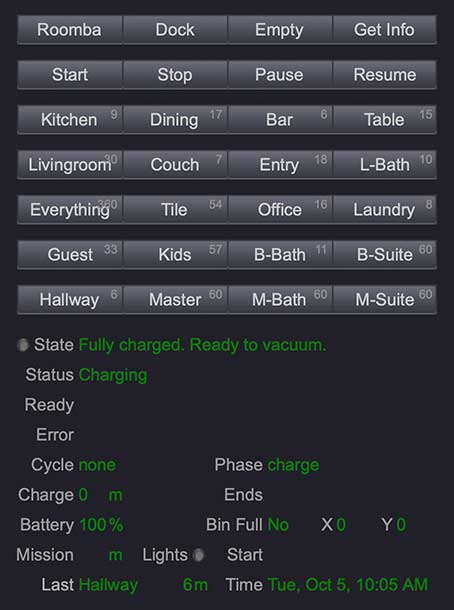

I have the main Roomba control and state elements in an area on my System page:
Mostly self-explanatory (at least to me!! :lol: ). The light grey numbers indicate approximate runtime for each area. Those were originally just labels, then I converted them to variables, because I was going to use them to determine how long an area's lights should stay on. But now the lights stay on until the Roomba is done vacuuming (but no longer), because runtime can vary by a lot, depending on too many factors. So the grey numbers are now just for my own reference (approximately how long a mission should take).
If the preferences and conditions dictate, an area's lights come on when I first click an area button. Those buttons then initiate the Roomba cleaning cycle for that area. This "one-click" setup is so much more convenient than messing with the iRobot app, which has too many features requiring too many touches to get the vac going. Not to mention my app regularly loses contact with my Roomba, requiring an app restart. Seems to be a known issue. The plug-in has yet to lose track of my Roomba. Hey, if you're going to pay to make vacuuming automatic, might as well make it as convenient as possible!
The last line is where I track the last area that was cleaned, how long it took, and when it occurred.

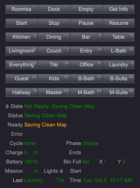

Towards mission end:
Green indicator went off when the Roomba finished vacuuming.
The yellow Lights indicator (and the area's lights) went off when the Roomba docked.
NotReady text shows up as orange.
ErrorText shows up as bright red.
