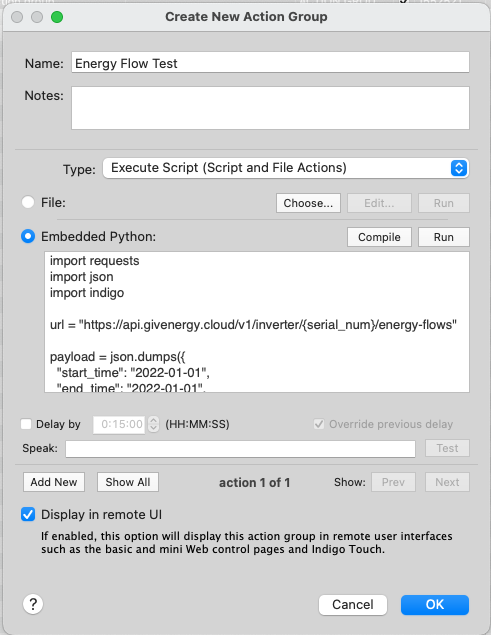

Somebody kindly on the GivEnergy forum used the same options in the payload I am trying and it worked which is actually even more of a head scratcher. Lets change tack and try the following

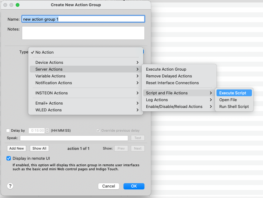

Create a new action group for execute a script
Choose embedded python, and paste the code below in the window (adding in your API key and Inverter serial number)
and click run. You should see the output in the event log, and hopefully we will see something like
Which is the response the givenergy user got.
That will rule out my code at least. If you get errors you could try adjusting the dates.
If this doesn't work then maybe a zoom call and setting up postman so we can run it live (postman is a tool for testing API's and Givenergy have a collection which is a way of running all of the calls)
Fingers crossed.
Neil
{"data":{"0":{"start_time":"2022-11-16 00:00","end_time":"2022-11-16 00:30","data":{"0":0,"1":0,"2":0,"3":1.85,"4":1.13,"5":0}}}}
Fingers crossed.
Neil

Ok, that works, I'm getting the following result
I ran it twice just to make sure
M
Action Group Energy Flow TEST Script
Script {"data":{"0":{"start_time":"2022-11-01 00:00","end_time":"2022-11-01 00:30","data":{"0":0,"1":0,"2":0,"5":0.14}}}}
Script {"data":{"0":{"start_time":"2022-11-01 00:00","end_time":"2022-11-01 00:30","data":{"0":0,"1":0,"2":0,"5":0.14}}}}M

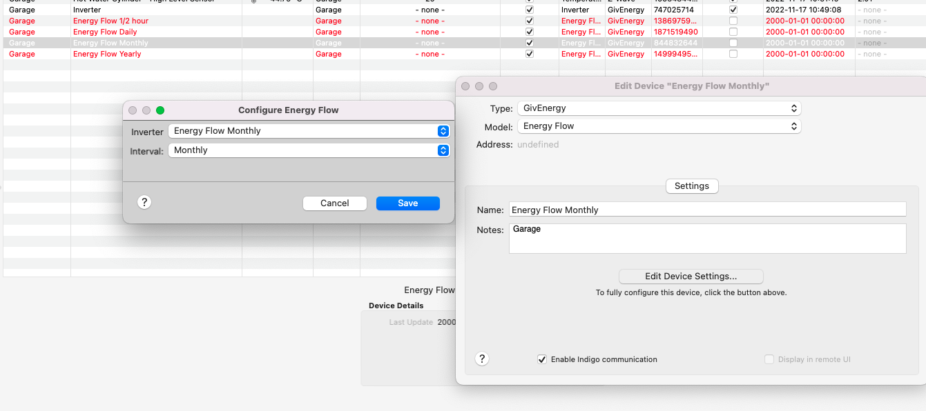

I think we should do a Zoom call as I'm not sure I;m setting this up right!
I've upgraded to the new plugin which seams to work fine. But when configuring the Edit Device Settings I'm not sure I'm setting it up right.
With the code below I just had the Energy Flow Daily switched on.
GivEnergy Debug URL is: https://api.givenergy.cloud/v1/inverter/xxxxxxxxxx/system-data/latest
GivEnergy Debug Headers are:
GivEnergy Debug {'Authorization': 'Bearer .eyJhdWQiOiI5NTc3MDIxOS1jYWE2LTRmOTctOTE3Ni0zNDBlZGMzZDQxNTgiLCJqdGkiOiIzMTI5YjAyM2I2ODlhNTY1OTIyYmRhMzdmZjJkOTdiZjI4NzViZThkYzA3OGM5MmJmYmNlOTFjYTg4MjJhMmI1YTE0MjZlYTkwY2VhNmUwOSIsImlhdCI6MTY2Njk4MjkyNi4yNTkwNzcsIm5iZiI6MTY2Njk4MjkyNi4yNTkwODEsImV4cCI6MTY5ODUxODkyNi4yNTIzNzQsInN1YiI6IjE5MjE5Iiwic2NvcGVzIjpbImFwaSJdfQ.x_gjzmZbfdLyBsFyM-yZvgflfCGGKaKRsqOT', 'Content-Type': 'application/json', 'Accept': 'application/json'}
GivEnergy Debug API Response was:
GivEnergy Debug {'data': {'time': '2022-11-17T10:45:02Z', 'solar': {'power': 1957, 'arrays': [{'array': 1, 'voltage': 226.5, 'current': 4.4, 'power': 995}, {'array': 2, 'voltage': 220.2, 'current': 4.3, 'power': 962}]}, 'grid': {'voltage': 246.1, 'current': 7.6, 'power': 312, 'frequency': 50.08}, 'battery': {'percent': 100, 'power': 0, 'temperature': 13}, 'inverter': {'temperature': 32.2, 'power': 1856, 'output_voltage': 247.5, 'output_frequency': 50.07, 'eps_power': 0}, 'consumption': 1523}}
GivEnergy Debug Updating Flow device: Energy Flow Daily with aggregation 1
GivEnergy Debug Which is linked to Inverter xxxxxxxxxx
GivEnergy Debug xxxxxxxxxx
GivEnergy Debug Daily Reporting
GivEnergy Debug Start Time is 2022-11-17
GivEnergy Debug End Time is 2022-11-17
GivEnergy Debug URL is: https://api.givenergy.cloud/v1/inverter/xxxxxxxxxx/energy-flows
GivEnergy Debug Payload is:
GivEnergy Debug {"start_time": "2022-11-17", "end_time": "2022-11-17", "grouping": 1, "types": [0, 1, 2, 3, 4, 5]}
GivEnergy Debug {'Authorization': 'eyJhdWQiOiI5NTc3MDIxOS1jYWE2LTRmOTctOTE3Ni0zNDBlZGMzZDQxNTgiLCJqdGkiOiIzMTI5YjAyM2I2ODlhNTY1OTIyYmRhMzdmZjJkOTdiZjI4NzViZThkYzA3OGM5MmJmYmNlOTFjYTg4MjJhMmI1YTE0MjZlYTkwY2VhNmUwOSIsImlhdCI6MTY2Njk4MjkyNi4yNTkwNzcsIm5iZiI6MTY2Njk4MjkyNi4yNTkwODEsImV4cCI6MTY5ODUxODkyNi4yNTIzNzQsInN1YiI6IjE5MjE5Iiwic2NvcGVzIjpbImFwaSJdfQ.x_gjzmZbfdLyBsFyM-yZvgflfCGGKaKRsqOT, 'Content-Type': 'application/json', 'Accept': 'application/json'}
GivEnergy Error HTTP error getting Energy Flow Daily xxxxxxxxxx data: 401 Client Error: Unauthorized for url: https://api.givenergy.cloud/v1/inverter/xxxxxxxxxx/energy-flows
GivEnergy Debug Updating Flow device: Energy Flow Yearly with aggregation 3
GivEnergy Debug Yearly Reporting
GivEnergy Debug Start Time is 2022-01-01
GivEnergy Debug URL is: https://api.givenergy.cloud/v1/inverter/xxxxxxxxxxenergy-flows
GivEnergy Debug {"start_time": "2022-01-01", "end_time": "2022-11-17", "grouping": 3, "types": [0, 1, 2, 3, 4, 5]}
GivEnergy Debug {'Authorization': 'eyJhdWQiOiI5NTc3MDIxOS1jYWE2LTRmOTctOTE3Ni0zNDBlZGMzZDQxNTgiLCJqdGkiOiIzMTI5YjAyM2I2ODlhNTY1OTIyYmRhMzdmZjJkOTdiZjI4NzViZThkYzA3OGM5MmJmYmNlOTFjYTg4MjJhMmI1YTE0MjZlYTkwY2VhNmUwOSIsImlhdCI6MTY2Njk4MjkyNi4yNTkwNzcsIm5iZiI6MTY2Njk4MjkyNi4yNTkwODEsImV4cCI6MTY5ODUxODkyNi4yNTIzNzQsInN1YiI6IjE5MjE5Iiwic2NvcGVzIjpbImFwaSJdfQ.x_gjzmZbfdLyBsFyM-yZvgflfCGGKaKRsqOT_k6EwCKSF', 'Content-Type': 'application/json', 'Accept': 'application/json'}
- Screenshot 2022-11-17 at 10.52.20.png (144.62 KiB) Viewed 2785 times
