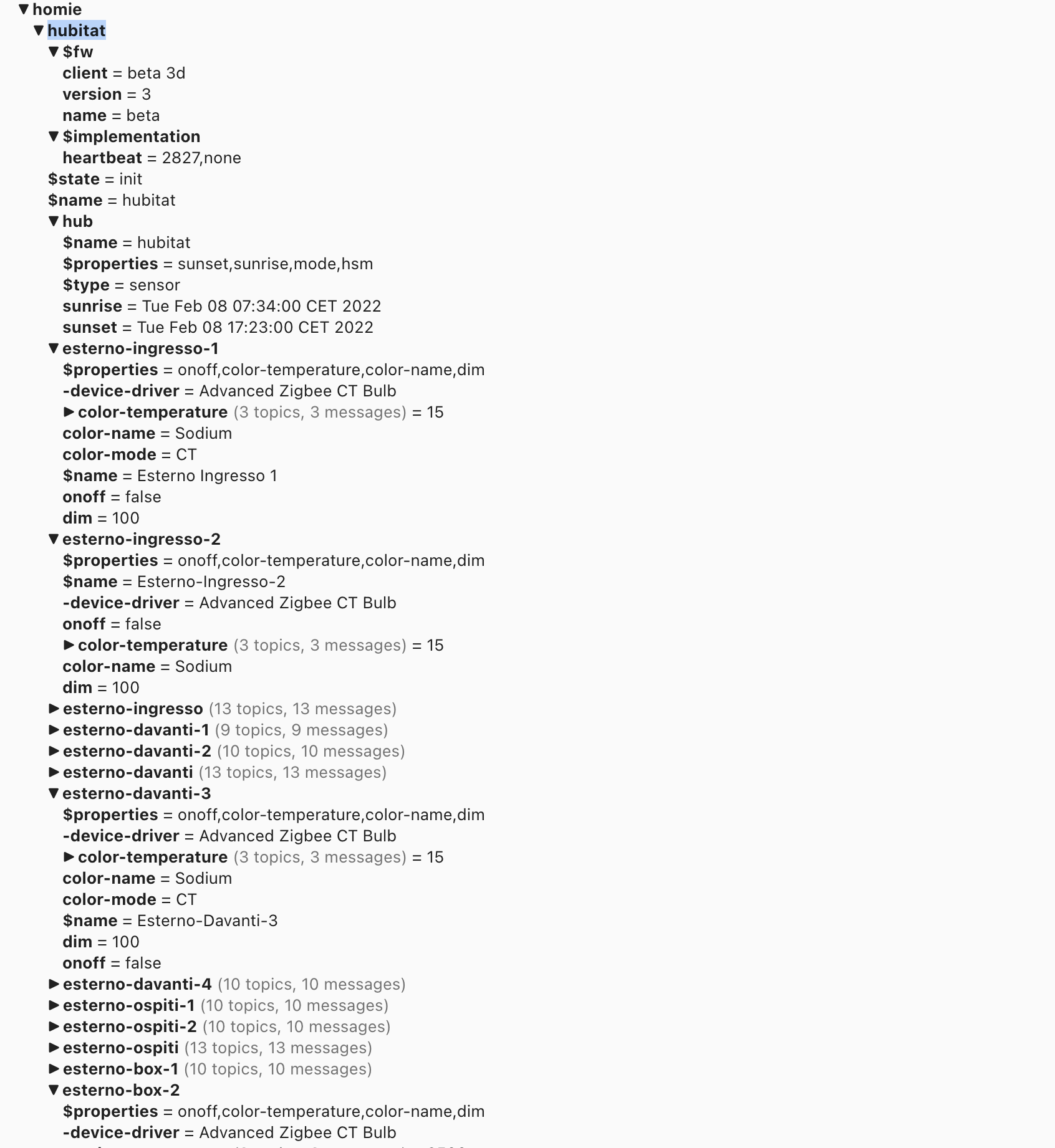

Here a screenshot, but I did not expanded all the nodes (do not fit in the screen :D )
If you need something in particular let me know.

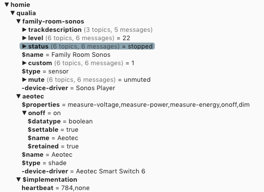

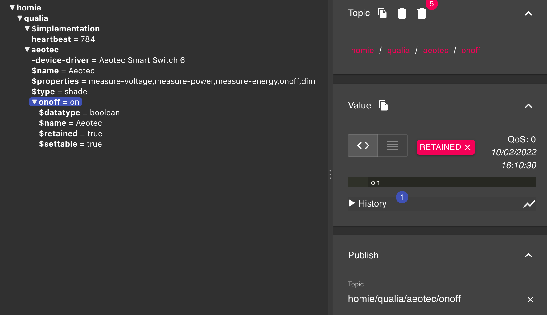

Wow! That was quick, thanks!
Can you post a screen grab of MQTT Explorer showing the homie node with all sub-nodes expanded?
I will then more likley be able to see why the device isn't being detected.
Screen grab attached. I have not fully expanded the Sonos device, as it's the Aeotec Smart 6 test device ("Aeotec") I've been concentrating on.
Thanks again for being so responsive.
mclass
Screenshot 2022-02-09 at 10.02.02 pm.png (58.41 KiB) Viewed 4464 times

Hi @mclass,
Thanks for the screengrab :)
Looking at the $properties, they seem to have a space after the commas which is what I think is throwing the plugin?
The easiest thing to do is to:
  1. Update the $properties in MQTT Explorer by publishing a topic of homie/qualia/aeotec/$properties with a payload of measure-voltage,measure-power,measure-energy,onoff - Note the removal of dim which isn't appropriate for an outlet
  2. Once you have done, reload the plugin and try again.
I will make a change in the plugin in due course to handle the spaces. :)
There are no discernible (to me!) spaces after the commas. However I did what you suggested to no avail :(

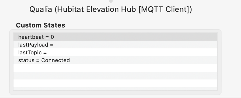

What is mystifying me is that despite the Hubitat plugin "HE Hub device" showing connected, the other custom states are vacant (see screen shot 1). If, however, I subscribe to the "homie" topic in the MQTT Connector app, these states are reflected (see screen shot 2). This would suggest that the Hubitat Indigo plugin is not subscribing to the homie topic?
Any suggestions at this stage would be welcome!!

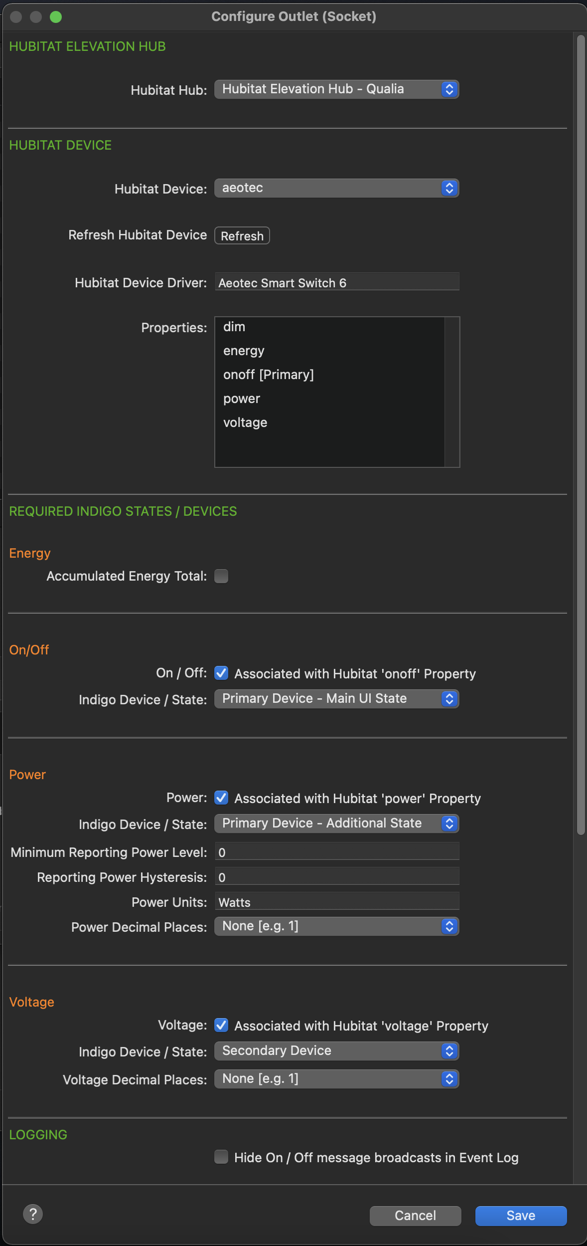

Hi @mclass,
I have spent sometime this afternoon trying to recreate and resolve the issue you are experiencing, so far without success.
I setup topics in MQTT Explorer, like this:
I setup all topics as retained with a QOS of 1.
I then setup a Hub based on qualia and then went to add a device and can do so successfully:
So, your definitions seem to work on my system. :?
I am beginning to clutch at straws, but here are some things I would check:
  • make sure the qualia name in the Indigo Hub settings is in lowercase
  • make sure that topics listed in MQTT Explorer show as retained (see image). You can normally test this by quitting MQTT Explorer and then launching MQTT Explorer again to check everything is still there and hasn't disappeared.
  • In HE make sure that in the MQTT App > MQTT Publish Formats that Complete & compliant homie topics is on
I am obviously missing something in your mix but can't put my finger on it at the moment.

Bingo!!
It was that "undocumented feature" requiring a lower case "q" that trapped me - together with a minimal understanding of MQTT!! :mrgreen:
Many thanks for your patience and tolerance - and even more thanks for the plugin!!

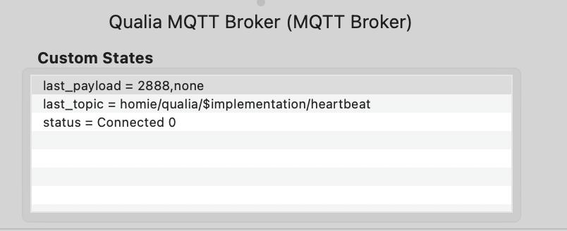

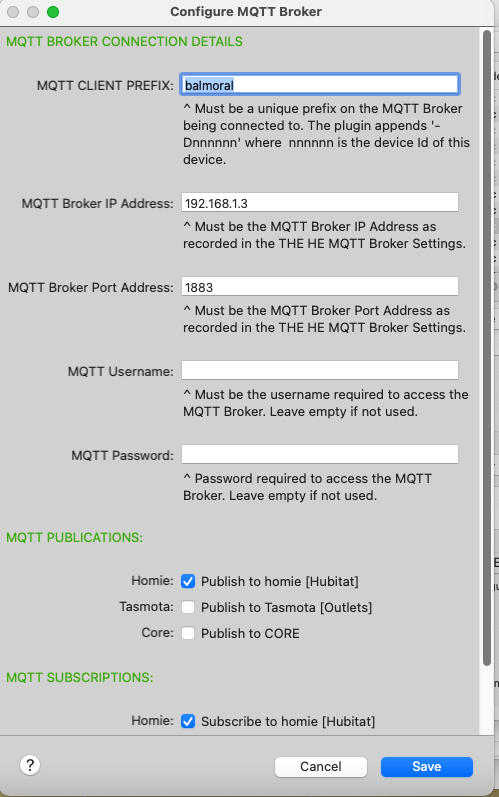

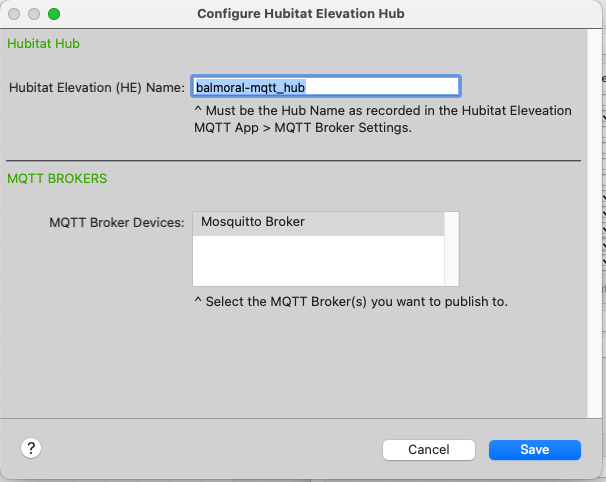

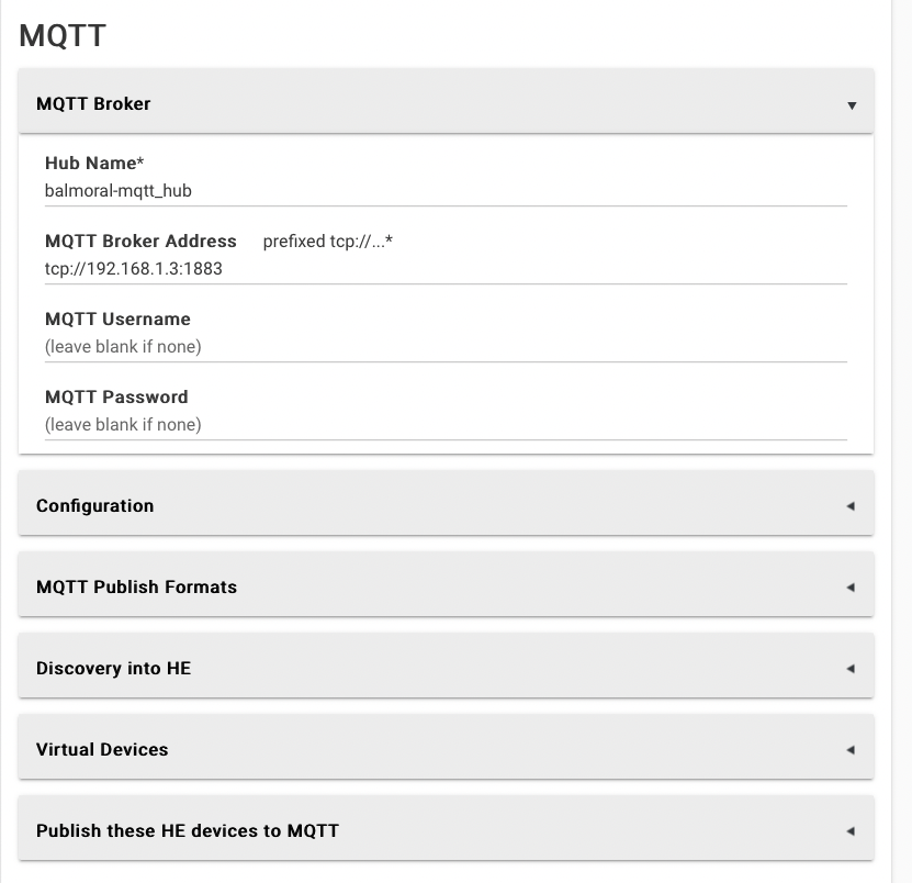

Hey Hubitat users, advice requested. It feels like something is wrong with the MQTT Broker or the Hubitat MQTT App, but I can't get a connection between the two platforms. Appreciate any thoughts, thanks.
- Installed Hubitat Hub - check
- installed (and enabled) MQTT app and drivers - check
- installed Mosquitto via Brew on Indigo MacOS platform - check
- tested Mosquitto MQTT messaging (locally) - check
- modified Mosquitto.conf - listener 1883 0.0.0.0 [and] allow_anonymous true - check
- disabled firewall on Indigo MacOS - check
- installed Hubitat Indigo plugin - check
- created Mosquitto Broker in Indigo, and status is connected - check
- created Hubitat Hub in Indigo, and status is disconnected - fail
Screen Shot 2022-06-16 at 2.59.08 PM.png (201.96 KiB) Viewed 3985 times
Screen Shot 2022-06-16 at 2.53.15 PM.png (21.09 KiB) Viewed 3985 times
Screen Shot 2022-06-16 at 2.52.34 PM.png (93.11 KiB) Viewed 3985 times
Screen Shot 2022-06-16 at 2.52.50 PM.png (43.58 KiB) Viewed 3985 times

Hi @7rdr7,
I think I have information overload! :lol:
Can I suggest that you use the App MQTT Explorer to see what is being published to the MQTT broker.
Note that you can also get this App from the Mac App Store.
Have you selected the devices to publish in the MQTT App.
What version of the Hubitat MQTT App are you running?
7rdr7
Posts: 200
Joined: Wed Aug 16, 2017 7:06 pm
Location: Gulfport, FL
Re: How to configure everything
Post by 7rdr7 »
Apologies for the overload :oops:
I figured that I was just missing something obvious, and I was......
Opened MQTT Explorer and noticed immediately that the MQTT app had converted underscores to dashes..... change them all to dashes, and everything works.
Thanks Jon!
