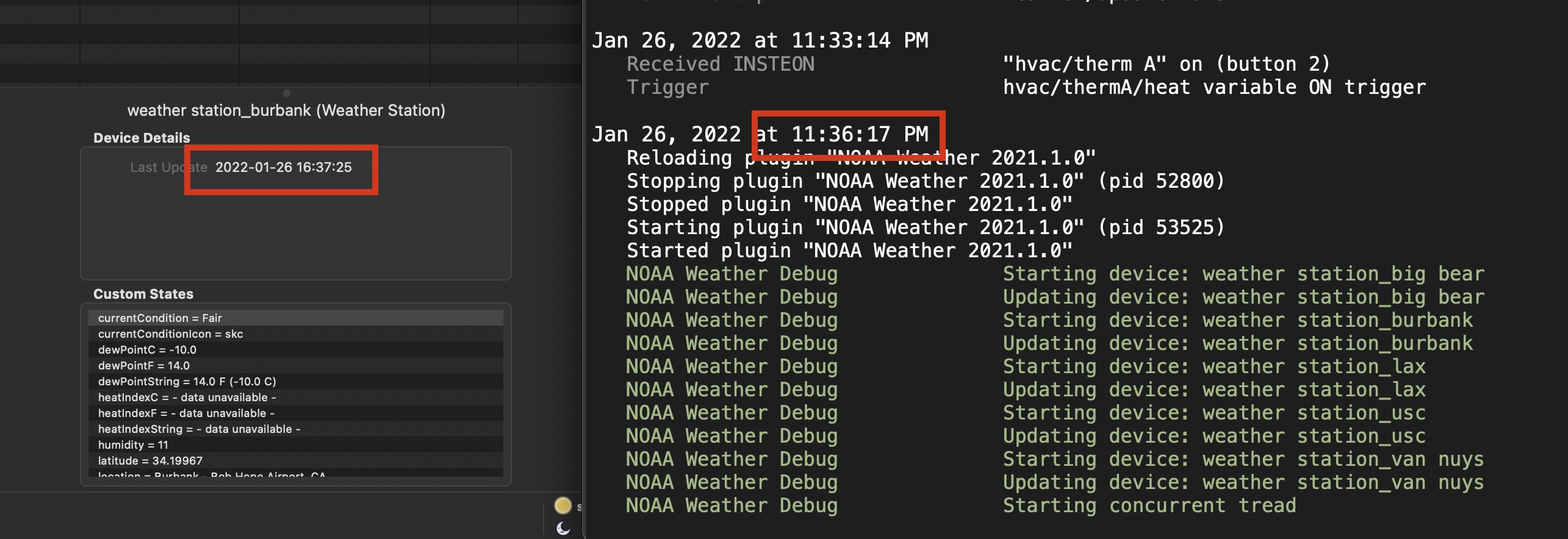

I am, as of today, seeing an odd update failure myself. I have four station devices config'd, usually all work very fine and no issues. Today, none of the stations has updates since 16:40 local; as of this writing that is 7 hours ago. I have checked the Metars and they are all updated since then but the plugin has not updated. Not sure if that means not polled or what, but I've reloaded the plugin a couple times and same behavior. No update on load (I assume it updates on load..?)
This will be an issue very soon for irrigation for me. Anyone else see this behavior? I'm using KBUR, KVNY, etc, for reference.
I suppose next step is totally restart Indigo and see if that breaks it free. Although not clear the issue. I will enable a higher level of debug now.
Thanks.
EDIT: Attaching screenshot, shows log on plugin reload:

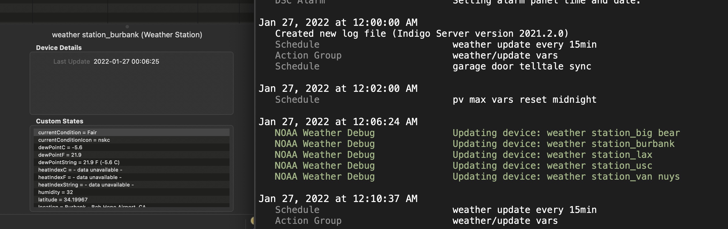

Seems to have updated a few mins ago. No idea what would have prevented the update all those hours, all systems were online and no comms issues. Nothing reported in log. I can't seem to find a place where NOAA xml feed system status is reported so.. Not sure how to diagnose, but .. it seems to be back.
Curious if others had that issue.
Thx
