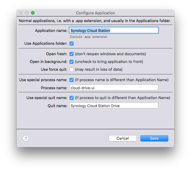

Appreciate the plug-in. I downloaded and installed it for a specific purpose, quitting and restarting an app called Cloud Station Drive for syncing to my Synology. Works great EXCEPT for this specific app. :roll:
This is what I've found.
1) Setting an app with the Synology Cloud Station as it's name will launch the app when it is turned on, but will not recognize the app as running and (therefore?) won't quit the app
figuring out that the app in the Applications folder launches a different app, led me to
2) The plug in correctly determines that "the app" is running with the following settings:
Application
Application name: cloud-drive-ui
path: /Users/jrickmd/.CloudStation/
it will not launch that app nor will it quit the app, unless...
3) It will correctly quit the app in question if:
use special process name: Synology Cloud Station Drive (which is what shows up in the Processes list of Activity Monitor
However, when I change that setting, quit the app and restart it, it NO LONGER registers the app as running. I have to go and uncheck the "use special process name" setting to make it "see" the app running again. The have to go back and re-select the use special process name so that it both recognizes and is able to quit the app.
I perceive I will have to have 2 different devices set with this plug-in so that one is able to quit and one is able to launch the app, but need the quit-able one to recognize the use special process name without me manually resetting that check box.
Happy to do any further explaining or testing you may need.
Rick

Sorry you're having an issue. That definitely sounds like a non-standard application. The plugin is just an indigo front end for basic terminal commands, so it's easiest to troubleshoot in terminal.
Can you launch the app and then run this command and post the results?:
ps -awxc -opid,state,pcpu,pmem,lstart,etime,args | egrep "[Cc]loud"

On further research, I discovered that the app in the Applications folder launches 3 different helper apps called by a different process name, AND uses a different app name to be able to close via Applescipt. :cry:
I tweaked the plug in to include another "extra" in the application device type as illustrated in the attached screenshot. I then added a 'quitName' key and changed the AppleScript to use that in it's quit call. Works perfectly now! :lol:
