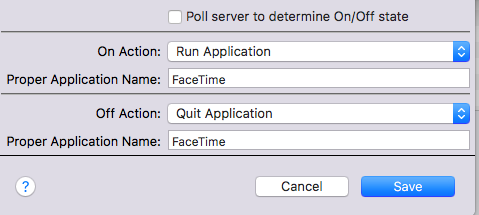

I have tried with kodi, apple store and FaceTime. i can start the applications but i can't shut them down.
6. des. 2016, 21.31.31
Action Group new action group 2 off
EPS - Mac Commander osascript -e 'set R to "eppc://**********@192.168.*.*"' -e 'using terms from application "Finder"' -e 'tell application "FaceTime" of machine R' -e 'quit' -e 'end tell' -e 'end using terms from
- Skjermbilde 2016-12-06 kl. 21.32.09.png (33.72 KiB) Viewed 6848 times
