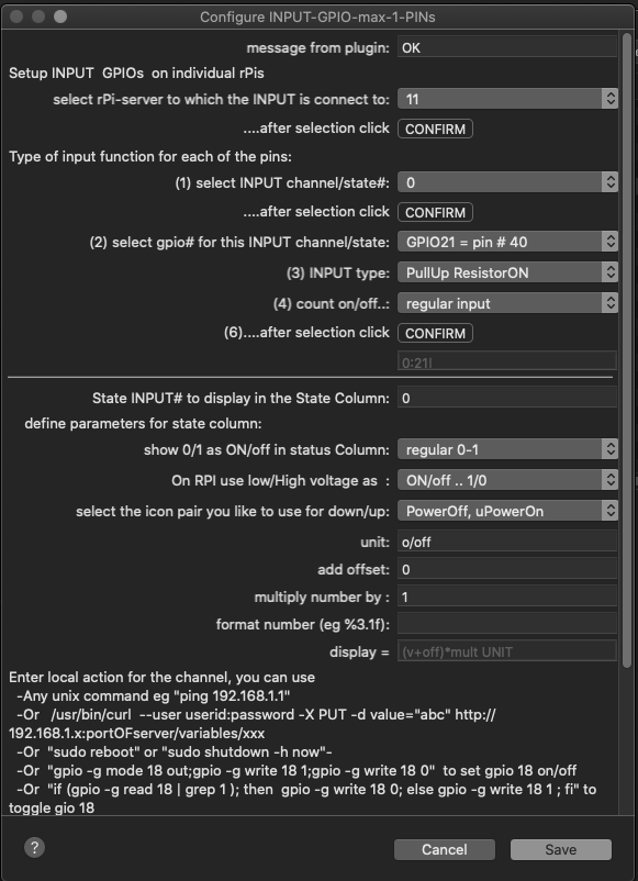

Attached the setup of a GPIO input pin #21:
Screen Shot 2020-06-24 at 07.08.24.png (123.16 KiB) Viewed 5858 times
The value is 1 if pin is connected to ground and 0 when open (switch is connected => 1, open = 0)
The RPI has internal pull up/down resistors. In the setup the internal pull -up resistor is used
You can use this simple setup if the switch is "floating" ie no electric connection to anything else.
As precaution you could add a simple diode (1n4148) with anode connected to GPIO pin and cathode (the end with the black ring) towards the switch.
This will prevent any current flowing back to the GPIO pin. The switch will still work fine.
When your state value goes up and down on its own it could indicate a loose connection.
To test that, connect your gpio pin directly to ground (w a 2 female jumper cable). The value should be stable. If that is true then your cable connection is likely flaky/loose/ .., if not your RPI might have a problem ( just double checked .. the software is working)
If the switch is not floating eg connected to a bell with its own voltage, things are more complicated. And you might need an optical isolation circuit. They are not expensive < $0.5.

Thanks Karl,
Thats really helpful- particularly the bit about pointing out the internal pull-up resistors.
I suspect you are right and it is a loose connection - will go check and report back.
Glenn

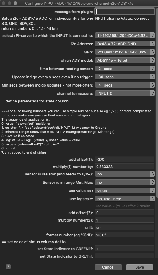

On to another issue:
Getting a lot of status - bad Sensor data,disconnected?
For the ADS1x15 device type... INPUT is fine, and have been reading that, but not sure why status isn't
(the calculation is being applied to INPUT, so doesn't seem to be that...)
But the INPUT/updates are running fine.
rpi #5
devid 1021059064 = fine -- status 886.0[mv]
devid 297270947 = bad Sensor data, disconnected? (But INPUT uptodate and correct.)
Seems like something happening in status calculation?

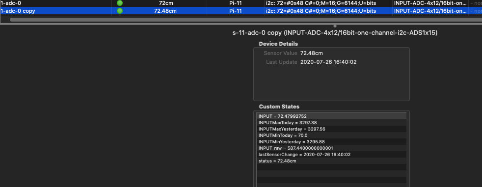

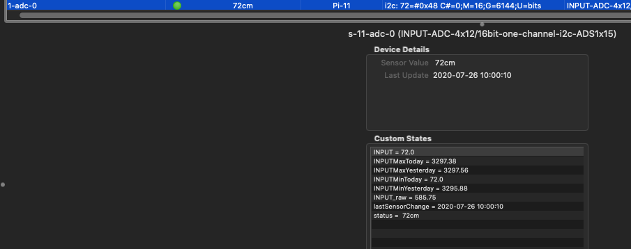

I tried to replicate your config, here my results:
Screen Shot 2020-07-26 at 10.00.29.png (40.14 KiB) Viewed 5706 times
Screen Shot 2020-07-26 at 10.00.42.png (133.08 KiB) Viewed 5706 times
You get the "bad sensor .." status when the sensor gets a read error: the only thing that changes is the status filed, no other state is touched in that condition.

duplicated the device (= same sensor/ channel) and only changed the format (%3.2f and 3.0f):
don't understand what's wrong with your config

remark: the 2 values don't need to be the same as they are read independently, so small variations are ok.
