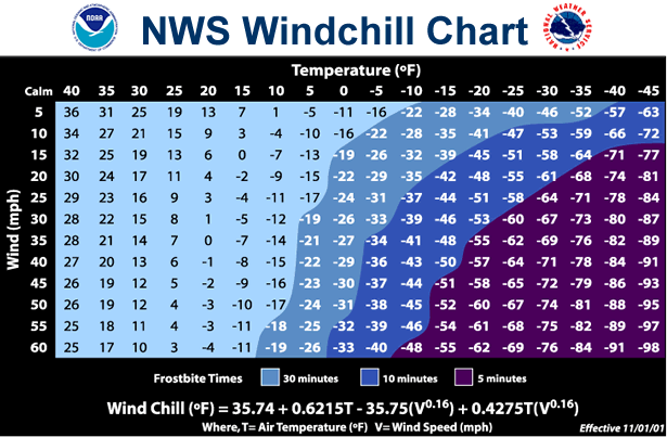

Dewster35 wrote:Not that I don't like the plugin's value, but since it is being calculated, how hard would it be to run it on my own from two indigo variables that contain the windspeed and temperature? I am 4 miles away from the airport and we are up on a hill on the other side of the bay so we get quite a bit different here.
It wouldn't be too hard at all. It could be calculated using either Python or AppleScript from your 2 Indigo variables. The formula used in the NOAA Weather Plus plugin is the one from the Wind Chill description page linked to earlier. From that page:
NWS Wind Chill calculation graphic
That was the plan... just not a fan of doing math in script :)

In case anyone hates scripting math as much as me, below is an applescript. You would create 3 variables in Indigo. HomeWind, HomeTemp and HomeWindChill.
I have this on a schedule to run every 15 minutes on a short delay after action collection populates the wind speed and temperature into the above variables.
set TEMP to 1
set WIND to 1
set WC to 1
tell application "IndigoServer"
	set TEMP to (value of variable "HomeTemp") as number
	set WIND to (value of variable "HomeWind") as number
end tell
set WC to round (35.74 + (0.621 * TEMP) - (35.75 * (WIND ^ 0.16)) + (0.4275 * (TEMP * (WIND ^ 0.16))))
	set (value of variable "HomeWindChill") to WC
end tell
