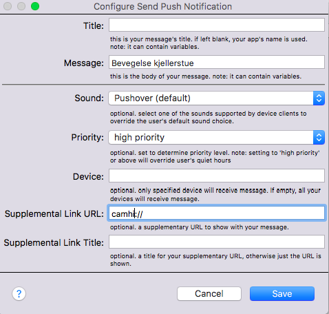

i want to open an app called CamHi when i get a pushover notification. i have tried several urls; camhi:// - CamHi:// - but it dont work.
Any suggestions ?
Any suggestions ?
