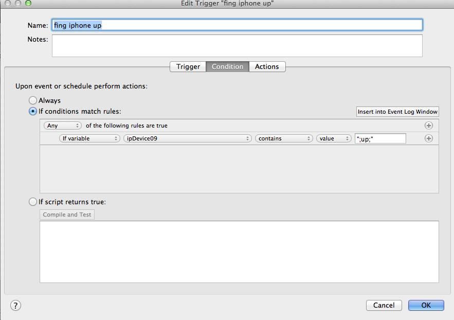

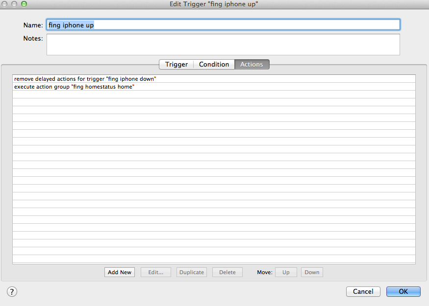

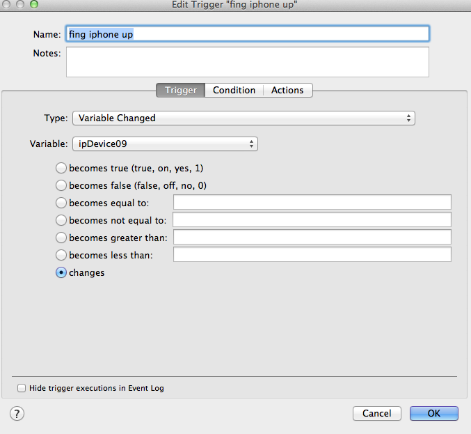

does this trigger look right?
Screen Shot 2013-12-11 at 7.02.25 AM.png (50.99 KiB) Viewed 5838 times
Screen Shot 2013-12-11 at 7.02.14 AM.png (62.33 KiB) Viewed 5838 times
Screen Shot 2013-12-11 at 7.01.58 AM.png (64.04 KiB) Viewed 5838 times
that trigger setup looks good. Please keep in mind each device has 4 states: ;up; ;down; ;expired; and ;changed; Fir this purpose up and changed is the same. ;changed; is a temporary assignment and will be overwritten with ;up; at the next update ~ 1 minute. ;expired; can only be changed to ;up; or ;changed; *)

i can watch my ipdevice9 change from up to down when i toggle wifi. but the trigger above is not changing the home status variable. ughhh.
remove the " around ;up; in condition. it will look for ";up;" not for ;up;
Seeker
Posts: 441
Joined: Mon Aug 05, 2013 5:08 am
Post by Seeker »
Thank the maker.
that did it. it seems to be working now. thanks so much.
