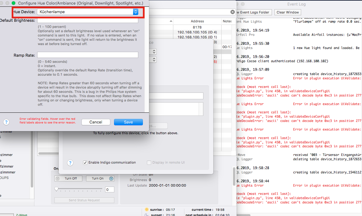

Post by yassi »
Hi Nathan,
can you please fix the issue in the plugin with the Umlauts?
I'm trying to add a bulb with the name "Küchenlampe" (kitchen lamp), see error log here:
08.06.2019, 19:58:44
   Hue Lights Error                Error in plugin execution UiValidate:
  File "plugin.py", line 450, in validateDeviceConfigUi
UnicodeDecodeError: 'ascii' codec can't decode byte 0xc3 in position 277: ordinal not in range(128)
Thanks in advance!
Yassi
Bildschirmfoto 2019-06-08 um 19.58.46.png (284.16 KiB) Viewed 3496 times

Post by nsheldon »
I’ll see what I can do, but no promises. Python 2.x handles non-ASCII characters poorly and, honestly, I haven’t figured out how to fix it at every place text can be generated.
