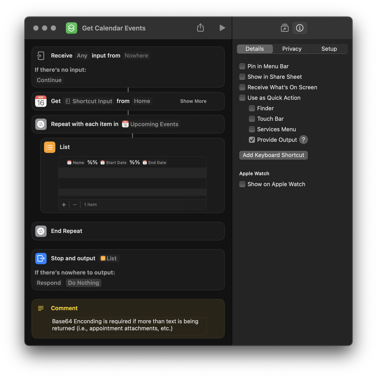

Shortcut
The shortcut layout:
Screenshot 2023-03-16 at 8.36.09 AM-2.png (868.63 KiB) Viewed 13379 times
The Shortcuts app isn't currently designed to output "complex" data containers like JSON or ordered lists, so the example uses a simple "hack" to work around this limitation. It puts all the requested information on one line in the list element to ensure that the data are all provided in a single payload. It separates the data elements with [space][percent][percent][space] which is used in the Python script to parse the event data. Setting the event details within the list is a bit tricky (and beyond the scope of this example).
There are some nuances about the way this shortcut works:
  • First, notice the tick mark next to "Provide Output". This option must be enabled or the shortcut won't return anything. Even though it looks like the "Provide Output" setting isn't meaningful because "Use as a Quick Action" is disabled, that's not the case.
  • Second, this shortcut outputs the data as a bytes() object that contains nothing but text. If you're going to try to work with Event attachments or other complex objects, you'll need to base64 encode them (beyond the scope of this example). If you use base64 encoding, you can forego the "Stop and Output" action as base64 encoding outputs by default.
  • Third, "Home" is the name of my calendar. You'll need to change it to one of your named calendars (or set it to examine all calendars).
  • Lastly, for simplicity, this example shortcut doesn't include any error handling.
