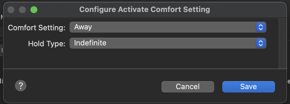

I'd like to tie my Ecobee's Away comfort setting to the state of my home alarm system. If the alarm is "Armed Away" I want to activate the "Away" comfort setting indefinitely. That seems straightforward.
When the alarm is disarmed, I would like a trigger to tell the Ecobee to go back to its daily schedule. Is that what "Resume Program" (and/or "Resume All Programs") does?

That'll probably work. "Away" is just one of the standard comfort settings. I assume you're doing comfort setting change like this. If so, resume will take off the indefinite hold and go back to the normal schedules.

Yep, that's what I'm doing. Perfect! Thanks.
