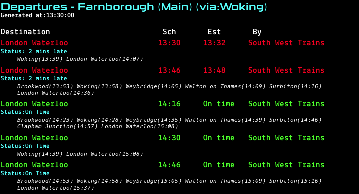

Here's a typical departure board output from one of my control pages - you can find more examples in the Manual.
Typical Departure Board
Screen Shot 2016-08-24 at 13.31.59.png (72.11 KiB) Viewed 3871 times
