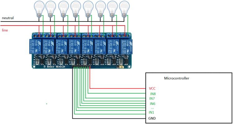

So am thinking one of these cards might come in handy for a few things, but don't fully understand how they operate. I'm assuming some kind of power supply is necessary just to make the card work, but from there, here's where things get a bit confusing for me.
One possibility is that once a rely is operated, the power from the supply that operates the card is tuned on to an individual relay.
And the other is the one I'm pretty sure to be true, is that each relay can have a different power "source", much like in the attached diagram. And while in this setup, all the relays have 110v bridged together, I'm half-way guessing one relay could have 110V as the source, one might have the output of an amp as the source and a speaker as the "destination", and yet another relay might have 25VAC to operate a irrigation system valve.
Not sure what other options there might be but want to make sure I'm thinking of this correctly.

I can address a couple of these questions. When a command is sent to an individual relay, the board voltage causes the target relay to open or close. The board voltage is completely separate from the line voltage for each load. Each relay is basically just a switch that completes (or breaks) the circuit attached to it.
I wouldn't recommend mixing things like mains line voltage with audio (or any low voltage). First, it's an invitation to lots of electrical interference. Second, it's not super safe and might be against your local electrical code. Given that these things are so cheap, if it was me I'd do mains voltage on one card, low voltage on a second card, and audio (etc.) on a third.

Super. Pretty much what I expected. And duly noted about different voltages. My plans are incomplete at the moment, but was just using line voltage and audio for my example.
