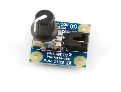

If a lamp controlled by the Meta-Device is also used as a controlling device you will have a loop, like what you are seeing. The basic idea of the Meta-Device plugin is to give a face to something that has no real physical appearance. This allows users to create "devices" that are really virtual in nature, but still appear in Indigo as "real" devices.
For example, I could use a rotary knob sensor like this: Image to control a group of lights. ( Of course, this assumes that Indigo can read input from the know somehow and also that someone has not written a specific plug in for the device. ) With the meta device plugin I can control the lights with the knob, or through Indigo's device window or via the iTouch app.
