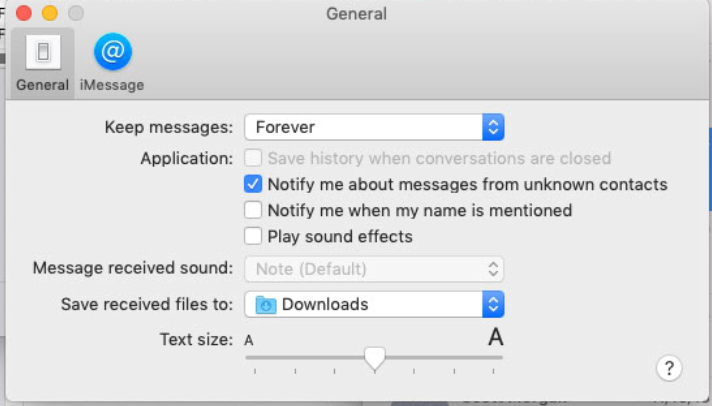

i've been using this plugin since it was released. yesterday i rebuilt my mini with mojave and I must be missing something. I cannot find the select the Run Indigo Message Plugin Action in the AppleScript handler list. in messages/settings.
any idea what i'm missing now?
###Installing the Messages.app handler AppleScript
In order to receive messages from the Messages application, go to Preferences on the Messages menu, choose the General tab, and change the value of "AppleScript handler" to "Open Scripts Folder". Look where you unpacked the .zip file earlier, and you will find an .applescript file. Copy it into the scripts folder, then close and re-open Messages Preferences, and select the Run Indigo Message Plugin Action in the AppleScript handler list. Due to a bug in Messages, new messages will not always reach Indigo if Messages is in the foreground, so put an Indigo window in front of it.

Seeker wrote:i've been using this plugin since it was released. yesterday i rebuilt my mini with mojave and I must be missing something. I cannot find the select the Run Indigo Message Plugin Action in the AppleScript handler list. in messages/settings.
It has been removed by Apple!. Had the same issue and was using iMsg a fair amount.
Have written a new plugin for Mojave - iMessage Plugin - in the plugin Store.
Or linked github for latest release - using wit.ai for natural language processing - will be in plugin store soon.
See it’s thread - does everything and more! Slightly different way of operating though - check the instructions, or post if need help.

thanks Glenn, that was easy. up and running again!!
