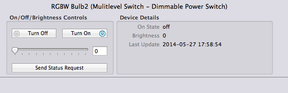

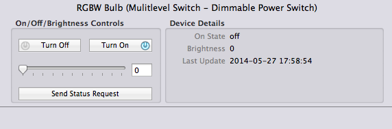

Just a small update on this. I don't know how RGB would be implemented on Indigo, but I have noticed that my RGBW device has been synced as two devices with a slider each. As of now these sliders control the same thing; the white light.
So I can turn on the white light with both sliders. I would assume that one of these sliders is meant to control the colour of the RGB light.
regards
regards
