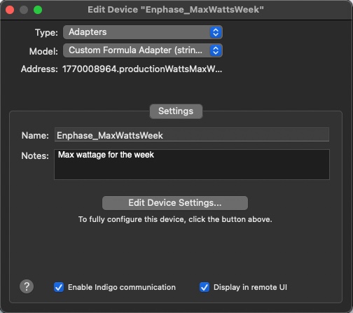

The 3 "state" values (productionWattsMaxEver, productionWattsMaxWeek and productionWattsMaxToday) were not created when I upgraded to v0.3.7. I had to manually create them using the "Adapters" type as the new device. Attached is the Adapter I created for the productionWattsMaxWeek value. Will those only be created automatically if I create a new Enphase Envoy-S?
Ralph

The three new custom state values are automatically created and added to existing Envoy-S device. I’ll check to see whether will apply to all types of Envoy’s…
If you pull the bottom bar up on Envoy-S device in indigo you will see the custom states. I have tested on 2 setups and they are automatically created.
They will start off at 0 until production happens and then calculate the maximums moving forward.
I still not sure what you mean by manually create them…. The fact that they show up as an option in the adapters plugin to me means that they are there already.

You're absolutely right! Sorry about that.
I totally forgot that when I started using your plugin, I created "Adapter" devices so I could control the format of your device "states." I'm using the "Adapters" plugin to accomplish that so there is one Adapter device for each of your Envoy states that I was using. After I upgraded to v0.3.7 I mistakenly was looking for the three new states under the devices list.
Man do I feel dumb! Sorry for all the confusion. Plugin is working great!
