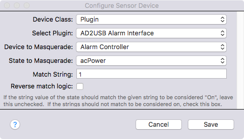

I'm trying to create a pretty simple virtual sensor but I can't get it to work.
I'm using the ad2usb plugin to control our Ademco alarm panel. That's working fine. I can control and monitor the states in Indigo without any problem. The issue comes in when I try to create a virtual sensor for the acPower state in the alarm keypad device. This is a binary state that is 1 when the panel has A/C power and 0 when it is running on battery so it can be used to detect a power failure.
I'm trying to expose the field to HomeKit via home bridge and I thought the Masquerade plugin would do the job nicely. It actually does show up in HomeKit just fine but the masquerade device doesn't ever see "on" state set. Here's the configuration for the device:

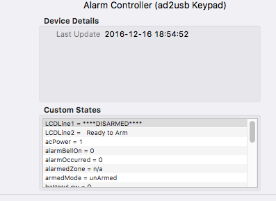

And here is the current state for the underlying device:
the current state of the alarm keypad

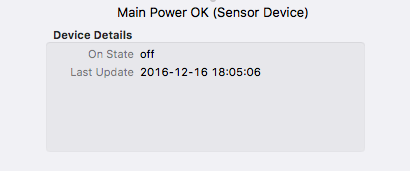

It seems like this should cause the masquerade device to be considered "on" but it, in fact, is off as shown below:
Am I doing something wrong or is some other issue causing a problem?

Can you turn on debug logging for the plugin, restart it, then post the log section? Doing whatever it takes to get that value to turn off and then back on in the ad2usb plugin would help.
I don't think you're doing anything wrong. I think I must not be converting the values properly for comparison.
One more thing - when you have debug logging on, change the device config and put "True" in the state value field instead of "1" and see what happens. It's actually a boolean field, but the UI is displaying it as 0/1. I'm thinking when I convert that boolean to a string internally, I'm getting "True" instead of "1".

Is it possible it is an initial state problem?
I did what you asked and I saw the states update properly in the log and in the device. Now it is showing that it is on.
However, I then created a second device with the same definition and it shows off. I tried reloading the plugin and it still shows as off though the original device shows on. Could it be that the device isn't checking the initial state when it gets created and only gets synced once the first match happens?

I can't proactively check the state. At least, I don't think I can. I only do an update when the Indigo server notifies my plugin that the underlying device had a change.
Restarting the other plugin after creating a Masquerade device is probably the right answer.

It never occurred to me to try restarting the underlying plugin. It might be something worth adding to the readme for those cases where it's not practical to trigger the state change to get things in sync. Thanks for your help in figuring out what was going on!
Some follow up:
Actually, restarting the underlying plugin didn't get things in sync so forcing an initial state change seems to be necessary. Still, so long as I know I need to ensure that happens I should be in good shape.

I'm not sure what I was thinking when I said I couldn't set the initial state without an update from the base device. I can. Try 0.0.7 using the internal updater or:
https://github.com/FlyingDiver/Indigo-M ... tag/v0.0.7

Worked great! Upon device creation it had the proper state. Thanks!
