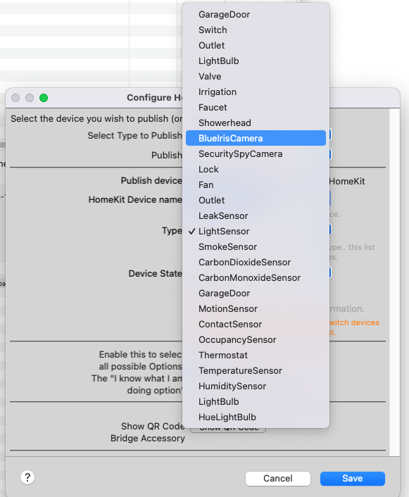

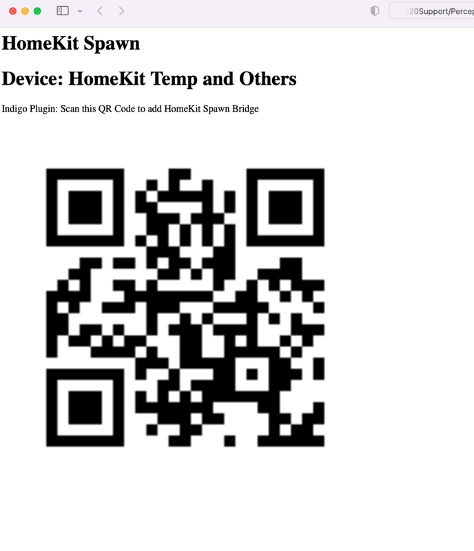

Ok.
Teaser of HomeKit Spawn... I'm sure some wondered what has been happening...
Yeah - pretty stuck with name... it does spawn a whole lot of new Homekit devices.. hence the name.
Getting there supporting devices...
Also have supported multiple, well really unlimited bridges... via HomeKit Spawn Device Bridges - create and away you go.
Each device is able to be independently stopped/started as is needed when new devices added.
Took a while to sort out given the asyncio nature, and threads (not the easiest combo) and probably not much advantage of multiple versus one or 2, except for setup and deletion/redoing..
Supports deleting accessories, readding etc.. all seemingly going well and haven't lost a bridge now for a number of versions...
(Homekit had a nasty habit of getting upset - limited testing but seems robust)
And finally adding new bridges - super easy - just create new bridge, select devices, save -- this will restart the Bridge.
Then go back into device and click Show QR Code - and viola! a QR code in web brower.
Easy to Scan in HomeKit app and couldn't be easier.
(Pincode - is also there in device states if needed - but QR code much quicker.)
